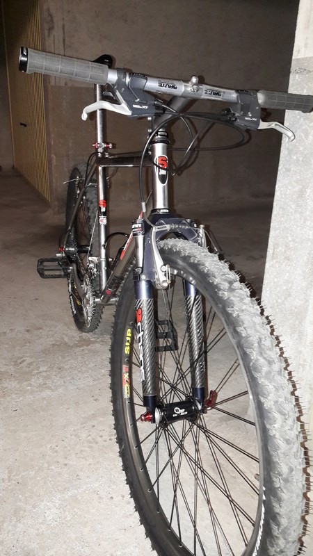

Well, some people could think I'm a little bit crazy, but the maxe is going back with xt parts and sunn fork :facepalm:
No offence to pace fans, but I couldn't stand it with this fork.
My brother will keep is 5000 :lol:
Hey,
A little pic of the bike outside of the garage from the last week end :
I had two little troubles on saturday : the steerer touched the tire and the rear shifting was not so fine with the road hg90 cassette.
I added one bar of pressure to the fork but I should probably put some 1.95 tyres to respect the sunn chaos notice.
The problem of shifting was solved wih an hg93 chain instead of sram pc8--.
Hi,
To be a little bite closer to the original maxe comp, I bought a specialités TA titanium bb :
145 g on the balance, but I need a lock ring for the left cup.
I will search a shimano instead of ta. Otherwise I will have to buy a ta tool...
Last update on the maxe comp :
The axix titanium BB has now a lockring on the left side : lucky me, it's ok with the cranlk arm :lol:
I upgraded the bike from 8 speed to 9 speed cassette to gain 40/50 g andadded some m970 shifters and a m901 front dérailleur.
In this configuration, the bike is quite light for a steel L size 8)
