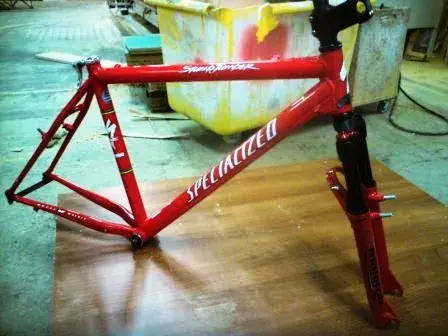

I bought this frame on ebay from a proper nice fellow who included some extras for a tiny fee :D

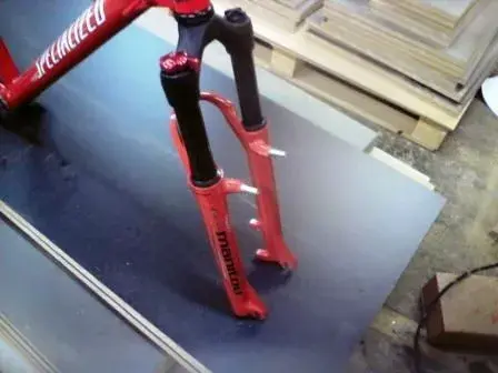

Anyway this is my first bike build I bought the forks separately for £1.20 (ebay again) and they're immaculate and work perfect :D
I'm borrowing the parts from my old GT to get it running while i gather more parts.
The build will consist of XT/XTR. I'm struggling with what colour cable outers to use and what wheels i should be looking for. I kinda wanna make it as light as my wallet/missus will allow so I'm not fussed about 2nd parts as i don't appear to have done bad so far :p
I'm sorry about the poor quality of these photos, I have used the camera on my phone and the plastic lens has 2 large scratches straight across it :(
Any ideas on parts and colours will be appreciated.
