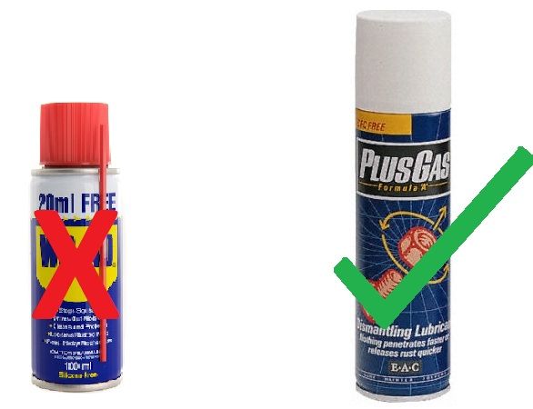

You can get cans of PlusGas which is even better for some applications. Also I'm not sure that overnight is always enough. A week is better.
Plusgas is the one, it's so much thinner than WD, it runs into every little crevice.
