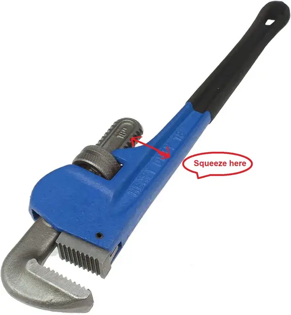

good Stilsons will grab the post for sure, less effective on alloy posts as its so soft but ive removed dozens of stuck posts with Stilsons
(Crimp the stilsons with your hand then lock it onto the seat post
