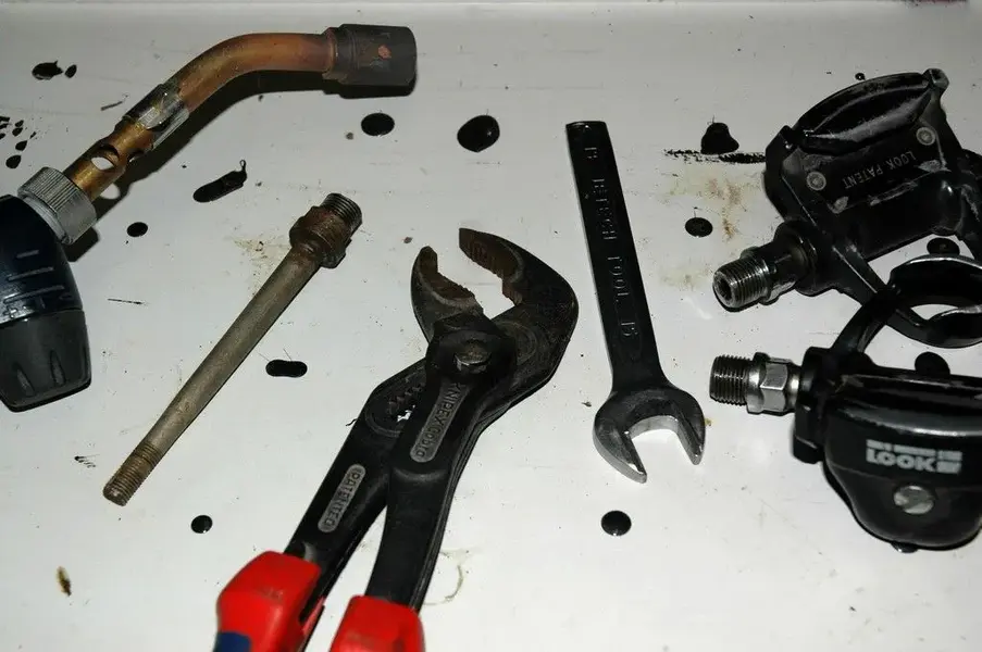

Collapsing threads would be a last option for me; where I would go slow and gradually increase the drill size; starting from the back of the crank side and no need to cut the entire axle off.
Interesting tool that stud remover. A bit unsure how it can work since a lot of pedals have a conical spindle.

Another note; the majority of stuck pedals have been on neglected lower - mid end bikes with nasty original steel / plastic cage pedals (VP / Wellgo etc.) that were put on the bike with very little grease to begin with. Also had a surprise case of wrong pedals being forced in the wrong cranks (ie. Left pedal in Right crank).
There are a few ways of doing it with welders.
You can heat the axle from the reverse side with a TIG welder, just have to be careful to not melt the crank arm. No filler needed, just use it for heat.
You could also cut off the axle close to the crank and MIG weld a large nut to it, the heat from doing this should crack the bond between axle and crank and with the large nut you would be able to get a socket and breaker bar on it.
The picture attached is a nut I had to MIG weld to a seized and broken bolt last week. That took about 160amps which is a huge amount of heat to put into a 6mm bolt but it works really well, just give it a chance to cool before you try to remove, huge amounts of expansion, so much the 10mm spanner didn't fit until the nut cooled back down.
