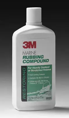

sum'tin like this?
3M™ Marine Rubbing Compound
Suggested for heavy, aggressive compounding of oxidized gelcoat and marine paint. Clings to paint and gelcoated surfaces - remains wet on the job with little or no mess. Buffs to high gloss with minimum of swirl marks. Can be used by hand or machine.
Full Description »
Maintains high rate of cut with constant pressure.
that IS cutting compound but may be too abrasive. you need something gentle so as not to damage the paint when you get down to the original. try G3 comnpound by 3M - body shops use it to flat off car bodywork after a respray. it is abrasive enough to cut through the paint but not so abrasive to strip loads off
