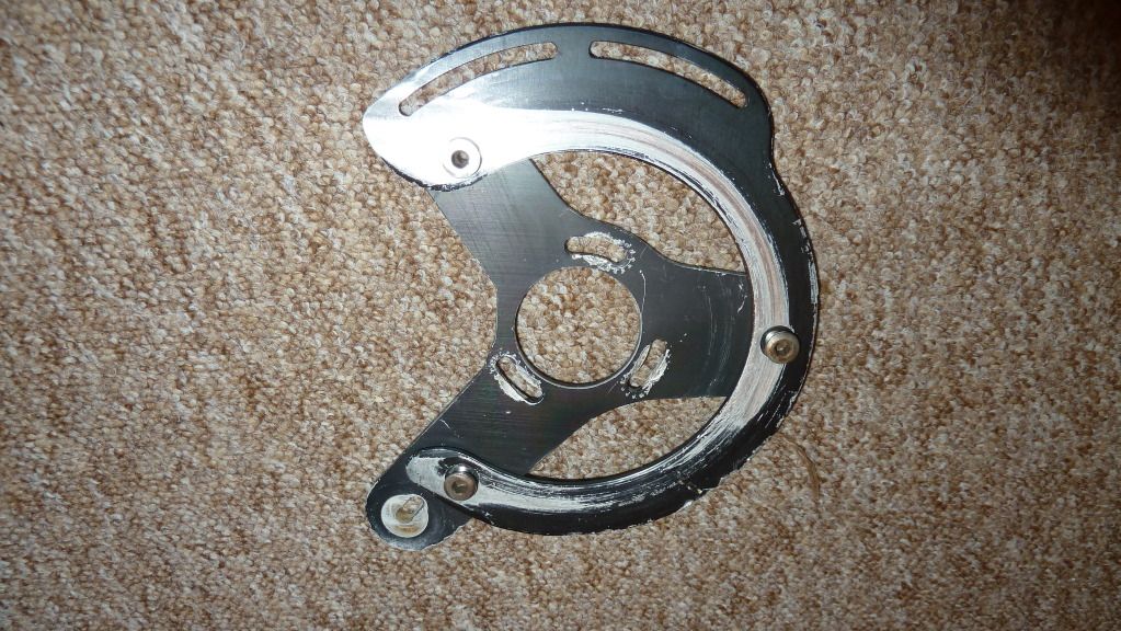

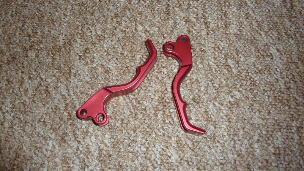

Stripping anodizing?
I have used bleach to do it before though, cant remember where i read to do it but it worked.
Wouldnt the soda pit the parts or is that timescale again?

Haha mixed bag we have here.
I wont be sanding the parts as there are alot of nooks and whatnot and its easier to source different colour parts over that.
The time differences are from either using oven cleaner (takes its time) or caustic soda/drain cleaner (seconds). Dont think bleach will shift it.
