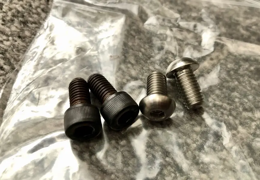

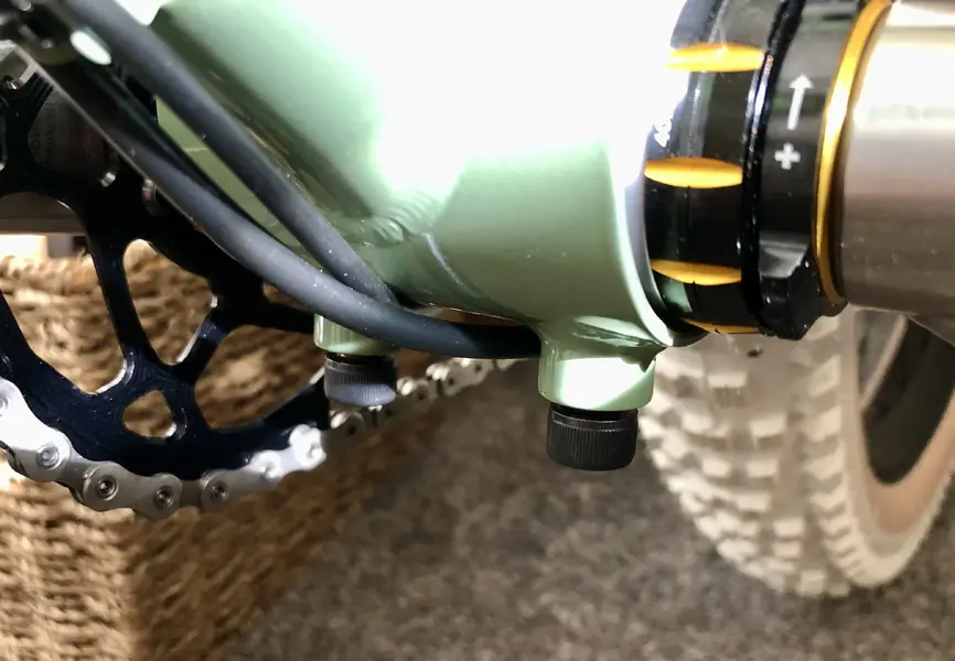

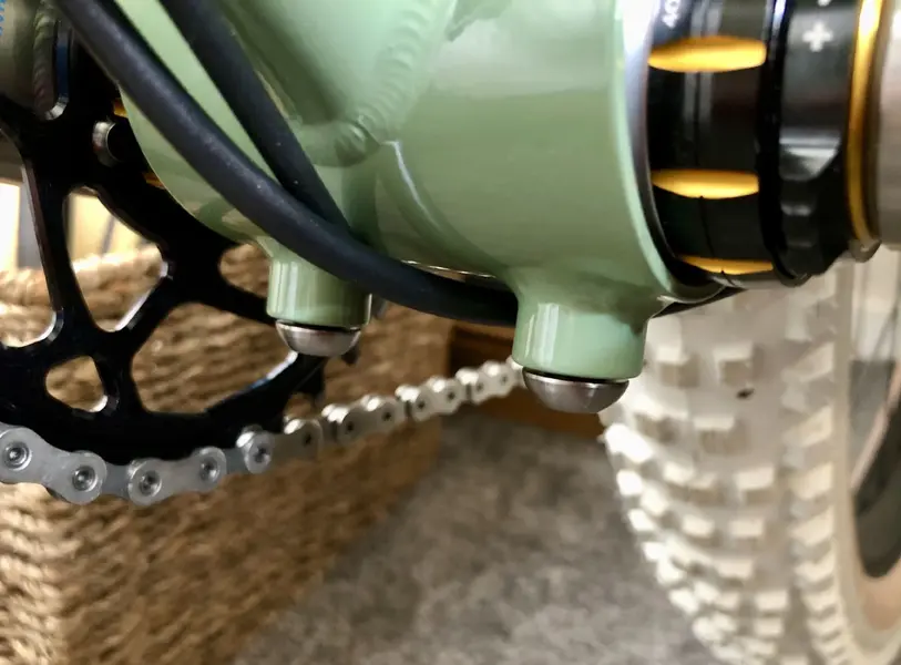

Swapped out the clunky looking, heavy, steel bolts on the EBB for some nice ti round heads instead 8)

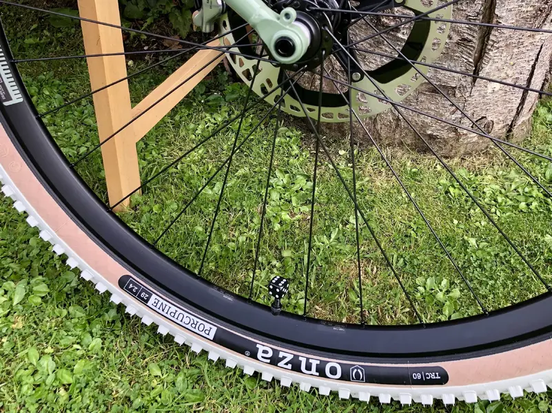

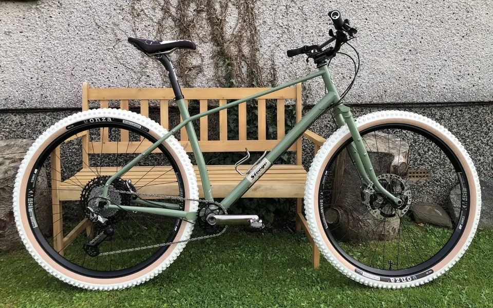

Last little bit of fun for the build arrived in the post today, some nice dice! :D
They're neatly made as they are properly drilled and tapped for the presta valve, no glued in valve caps in these ones!

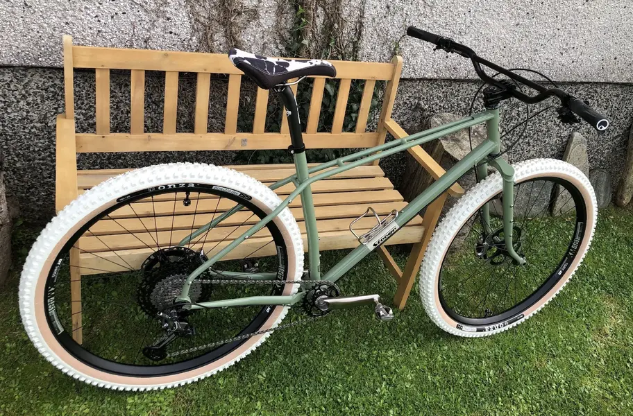

Saddle height set properly and the cables were trimmed down too, so all neat and tidy now!
Have just been for a spin round the block and it's very comfy, a little more upright position, and the bars don't feel wide at all which is a surprise considering they're 100mm wider than I was using! 8)

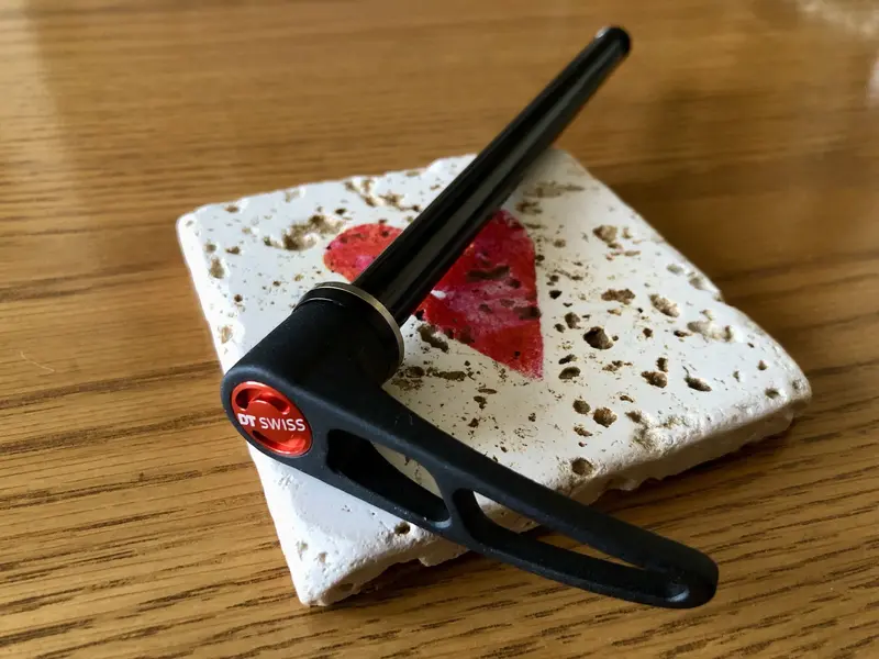

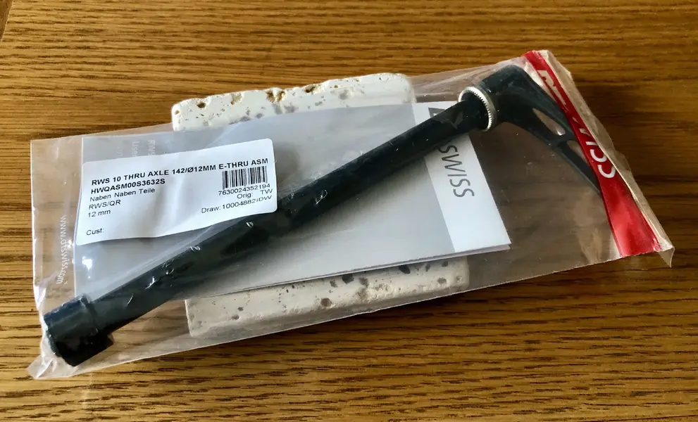

Why are thru axle sizes all so different....?! :evil:
The Scrambler frame is boost spacing, the hubs are boost @ 110mm and 148mm, yet the rear axle I need is listed as 142mm.....
It's the axle length and thread pitch that's important, and the 12mm rear is 171mm long which I managed to match up after doing lots of homework!
The front 15mm axle only measures 135mm however.... and the closest I can get is 142mm, so I'll need to find a 7mm spacer for that to work. :facepalm:

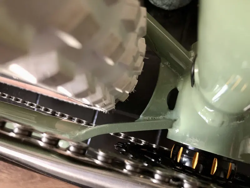

Quite nice :)
The rear wheel looks like goes a bit tight in that frame in the area of the chain rings? Perhaps it is a optical illusion.
Running 29 x 2.4 tyres and there's loads of room still :wink:
Re: Re:
coomber":2lpgav52 said:
Why do you want new axles?
You sound just like my wife! :lol:
I just prefer the adjustability and action of the RWS skewers with no cam-lock levers :oops:
