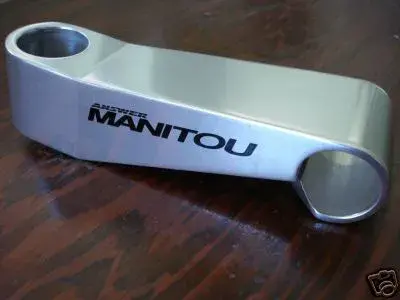

I just measured my Ringle stem, and it's 32mm also. Here's a pictue of a Manitou stem, it doesn't really look any shorter than any other stem.
