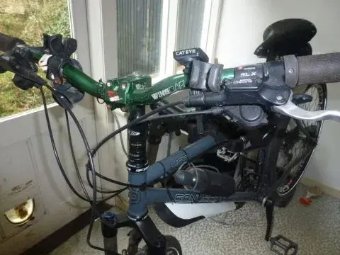

Anyone tried one of these ? Fork is a white brothers carbon, just a shame the steerer is a bit small. It would drop 1 1/2lb off the build for sure.
I prefer ride comfort to looks personally, sorry for the small image

Now Im only guessing, but id think the forces on the steerer for it to effectively snap it ,especially when you look at the thing skyhawk has fitted. Thats considerably more height than i was looking at so the tension/compression forces would be considerably greater. And many of the other gigantic set ups also seem to survive.

Sorry bud, but i find that look to be an affront to the eyes. No offence intended, but its ******* hideous look to any bike :lol: :lol:
Its the image I have in my head and on the build it doesnt look like it would win any aesthetic prizes, unless its the wooden spoon.
