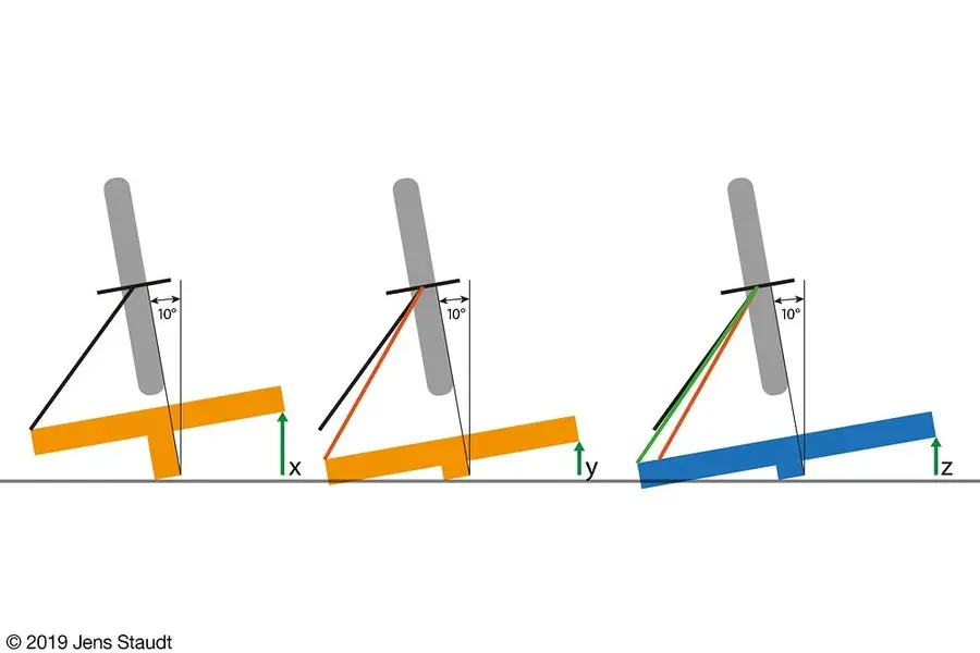

just adding a nice picture,
It's not from me, but I haven't asked the owner neither, if someone has a concern, just let me know
aHR0cHM6Ly9mc3RhdGljMS5tdGItbmV3cy5kZS92My8yMy8yMzQ1LzIzNDUxMDItc3RwZ3I0NGVyb2p1LWZyYW5rZW50cm...jpg
Just because this fits nicely to what @MattiThundrrr has said and illustrates nicely that stem length but also bar length do have quite a bit of impact on steering behavior.
The picture compares a long and short stem with same bar plus a short stem with a wider bar.
For same change of 10° of steering the long stem with short bar need most longitudinal movement of the bars at the side (x, y or z).
As shorter the bar and as shorter the stem smaller movements lead to bigger change of direction.
Having a too short stem, or too short bar can lead to an nervous steering. Wide bars need also short stems.
Rule of thumb: same longitudinal movement of the bar at the side with a 6cm wider bar leads to 1° less change of steering angle.
