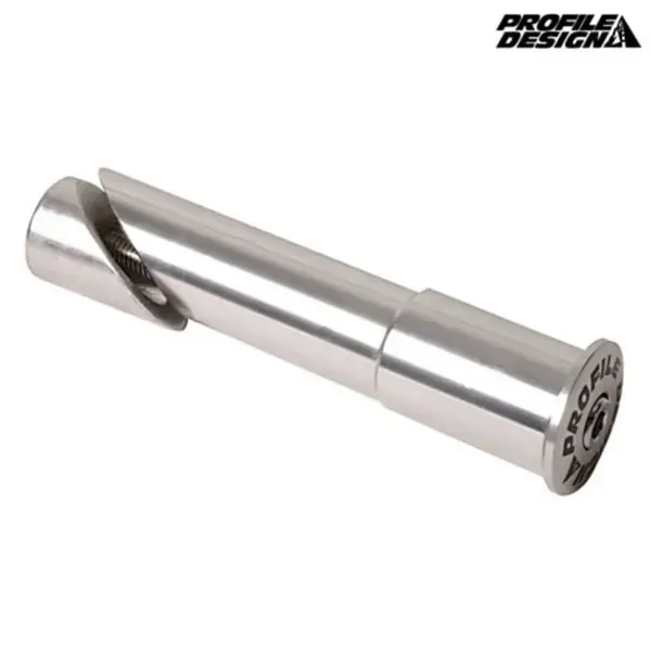

The idea of stuffing something solid and threaded at the top would allow to keep the threaded headset but then would need to use 1" ahead stem with a sleeve and internal thread for fixing the top cap. It could also be "pinned" to the steerer tube with something like a hammered in nail.
Why not just try one of these and convert the whole lot to 1" ahead?
https://www.sjscycles.co.uk/stems/p...1-inch-quill-to-1-18-inch-threadless/?geoc=FR
Would get you rolling but not period correct etc.
