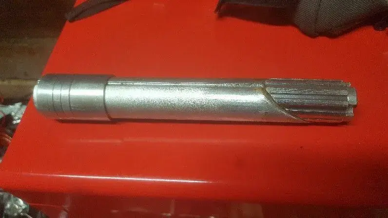

Anyway, steel 1"1/8 threadless steerer is a tad on the short side, not by much, but only half the stem fits on the steerer.
Balls :facepalm:
But a quick rummage turned up a BBB ahead steerer extender, result! :D
1"1/8 stem fits atop the spacers (tried it, no problem) , the remainder can be inserted down the steerer and the wedge expanded.
Except it can't, as it won't fit down inside the steerer !! . Tried it on another set of threadless 1"1/8 forks, same result. Tried it down a 1"1/8 threaded steerer and it would fit, just! It was rather snug...
What's going on? And how can I fix this?
(I want to keep the forks. My thinking at the moment is to turn/file/sand the adapter down enough to slide inside the steerer....).

Interesting. If you have a caliper, measure everything and see what tolerances you're working with on the components in hand, that might give more clarity as to the problems experienced.
From personal experience, some of these cheaper mass produced items can vary considerably within their manufacturing tolerance parameters, such as some cheap 40mm headset spanners I bought from ebay a few years ago, one would fit the headset nut, one was super tight and needed some filing. Maybe that's what's going on here.

They only fit down threaded steerer tubes as the thickness internally is different iirc. Had the same issue on a few of mine.
I figured it wouldn't fit an alloy steerer, but thought it'd be ok with a steel one, kind of what it's "supposed" to do !

Which forks are you using? I've used a steerer extender in the past many times (the head tube length on tiny frames seems to vary enormously :facepalm: ), including the BBB one.
Sorry if this sounds obvious, but make sure to loosen the wedge as much as you can before fitting - unlike good ol' quill stems, the extenders do seem to be a tight fit. If you remove the quill altogether and test fit just the extender part, you should find that it fits.

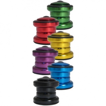

If all else fails, then a low stack stem and cheapo steel aheadset like this one (https://www.rippedknees.co.uk/eco-threa ... id=1295665) should do the trick.
Those cheap loose-ball headsets have a stack height of around 25mm (maybe less) and are surprisingly durable if you keep them greased . . . and did I mention all the lovely colours? :P
Cheers, yeah I did remove the wedge and bolt completely, just to rule out my own stupidity :lol: but it was still a no.
The forks are Manitou SX, going on a '97 Lava Dome singlespeed.
Current headset looks similar to the ones pictured, stem has a 40mm stack height.
I think even if I get lower stack parts I'll still end up with a stem slammed on the headset, and tbh I'd rather have a few spacers under the stem to raise it a bit.
I can live with the extra weight of the extender for now.
The fact the extender fitted inside a threaded steerer gives me hope that the difference in diameter is only tenths of a mm, nothing too drastic, and I should be able to remove excess material and use the extender.
I'll have a go at it this evening.
Also, fitting a length of old inner tube as a boot over the lower part of the headset keeps all the muck out.
