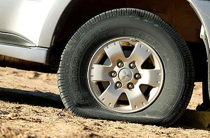

Ian,
They say a picture tells a thousand words -
Tee hee hee
Richard
p.s. bring back schoolboy humour!!
