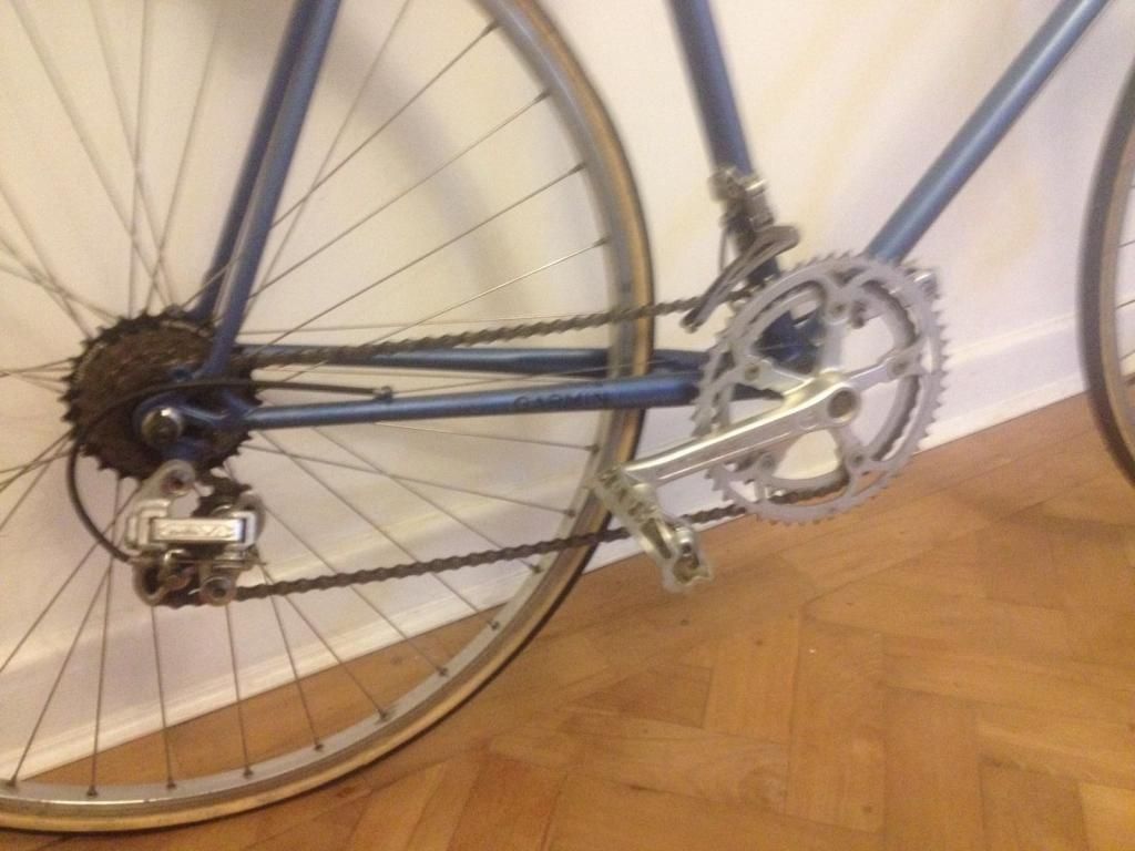

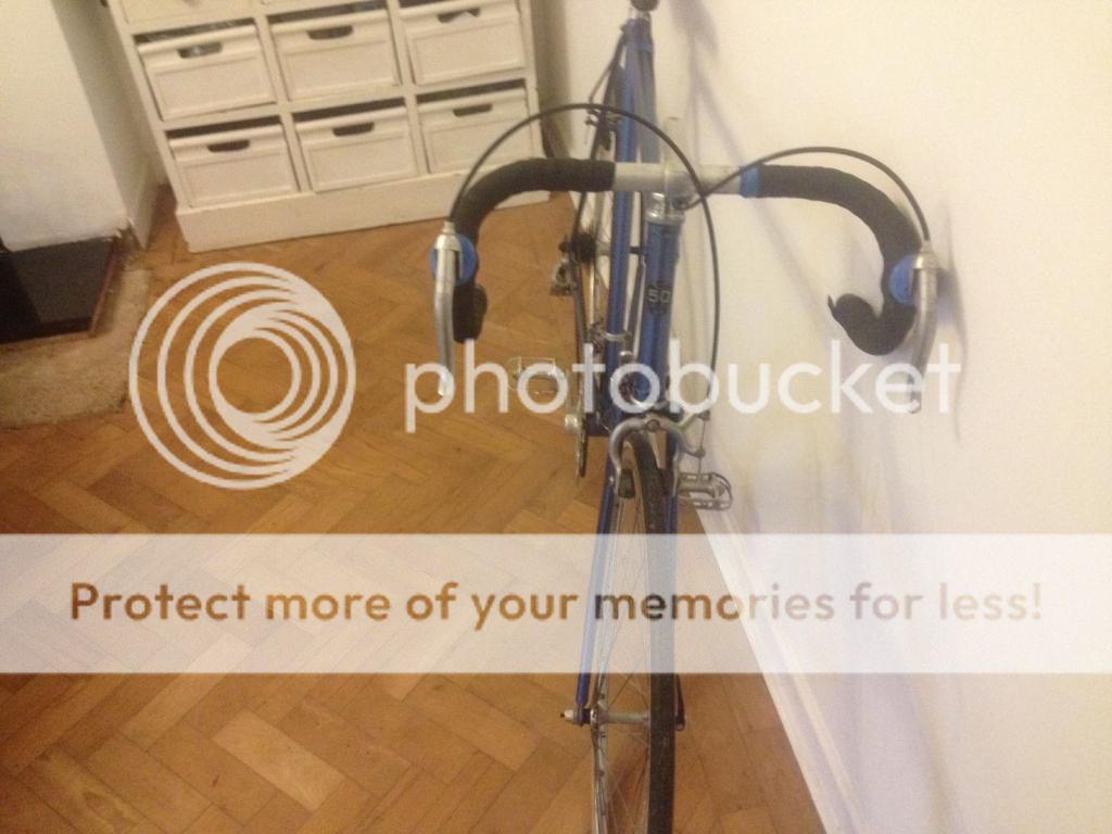

Here's a few more seller pics:
Apparently the drop-outs are Shimano. Sound right?
So what's this beast worth as a Carlton in need of a new paint job, bearing in mind the components I listed earlier in the thread?
Once again I find myself in awe of RetroBike knowledge! Ta guys
Shimano dropouts have a smaller triangle than those IIRC........
Still looks like a Carlton, sorry :(

In your esteemed opinion,is this a Carlton then?
It wasn't listed as a Carlton, but I know the 'maker' bought bikes 'in the rough' and sprayed/badged them as his own.
What era would you say? I thought mid 80s?
Its not crying out Carlton to me, its hard to see the lug details for a start. I can just about make out a 'Crespera shaped lug'...
Its a big frame and as far as I know only the Continental was made in that size, if so the forks look wrong, the rake is too shallow, more in keeping with a TT or track bike. It may well be later machine as has been alluded, in which case they did offer larger frames...
Looking at this further it has cast rear drop outs which point to a better frame than a Continental... Bit of a mystery so far...
Any better images?
