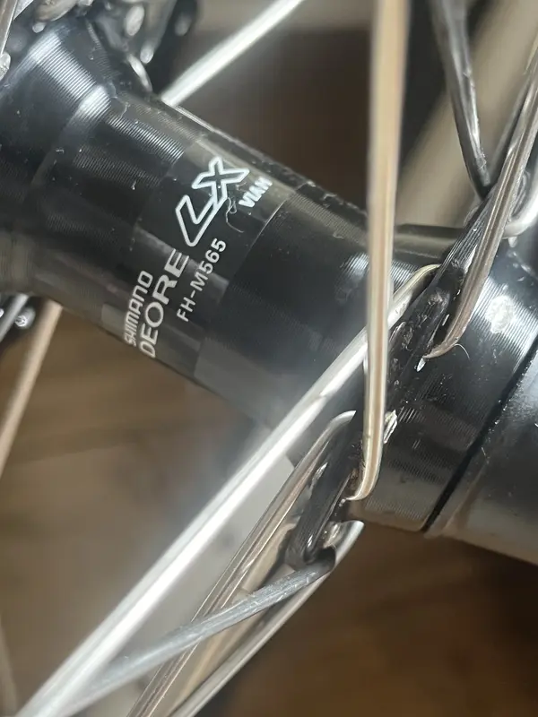

S sefton1275gt Retro Guru Jul 5, 2025 #1 Is this hub 8 speed only? I presumed a 7spd cassette would be fine but there's a lot of room left when I slide the cassette on
S sefton1275gt Retro Guru Jul 5, 2025 #2 I think the problem is Sram. I think I need a Shimano hyperglide.
D db95 Retro Guru Jul 5, 2025 #3 iirc 7s would require a spacer for an 8s hub, can't remember what size though - if correct I'm sure someone will be able to chime in with correct size
R RetroDavy Retro Guru Jul 5, 2025 #4 4.5mm is the spacer needed for a 7spd cassette on 8spd freehub body.
R RetroDavy Retro Guru Jul 5, 2025 #5 Like this one, but I'm sure eBay etc will have same inc post cheaper, https://www.sjscycles.co.uk/cassett...eed-cassette-on-8-speed-hub-body-spacer-each/
Takingabreak Dave Yates Fan Feedback View Jul 5, 2025 #8 It's an 8 speed hub and as previously mentioned, to use a 7 speed cassette requires a spacer as per @RetroDavy post. The previous version, M563 / 4, which looks similar is a 7 speed hub
