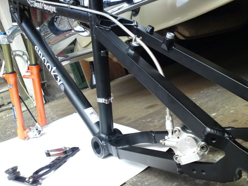

a small update to show where i'm at..
Had a nightmare getting hold of everything but the brakes are just about sorted, just waiting on a new front braided hose before a good bleeding all round. Need the rear Spooky mount also before i sign those off as done! ;) .. Squiffy has made me one so hopefully he'll come up trumps with that, cheers!
Headset went in no worries with the help of some hefty wood blocks and a hammer! so it's nice to have the front end built.
Gave up searching for the azonic bars so went with some DMR Wingbars which i think look great. Looking forward now to getting the bottom bracket once i figure out the correct length needed, then the cranks and chain guide can fit into place. Still need the right chainring which i haven't found yet but biding my time with that and a few other bits.
I'tll be hubs, get the wheels built then gears and drivetrain after that.. so not too long to go now hopefully :)

it has tried my patience somewhat but i'm quietly enjoying it now it's starting to look like something, and has come out better than i'd hoped so far..
roll on the end!

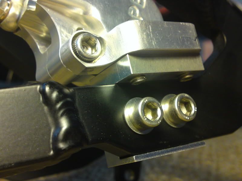

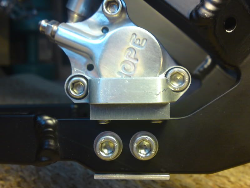

Had a nice little surprise through the letterbox this morning! the spooky mount :D
It's amazing how an inanimate piece of metal can excite someone so much!!
Many, many thanks to squiffy for getting that made for me! it fits like a glove and is made to perfection 8)
Relieved to be able to finally draw a line under that part, something that was niggling me right from the start of the build. There are some true saviours here for sure!
Cheers mate!!! :)
