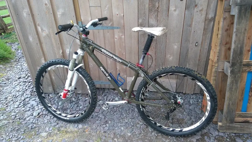

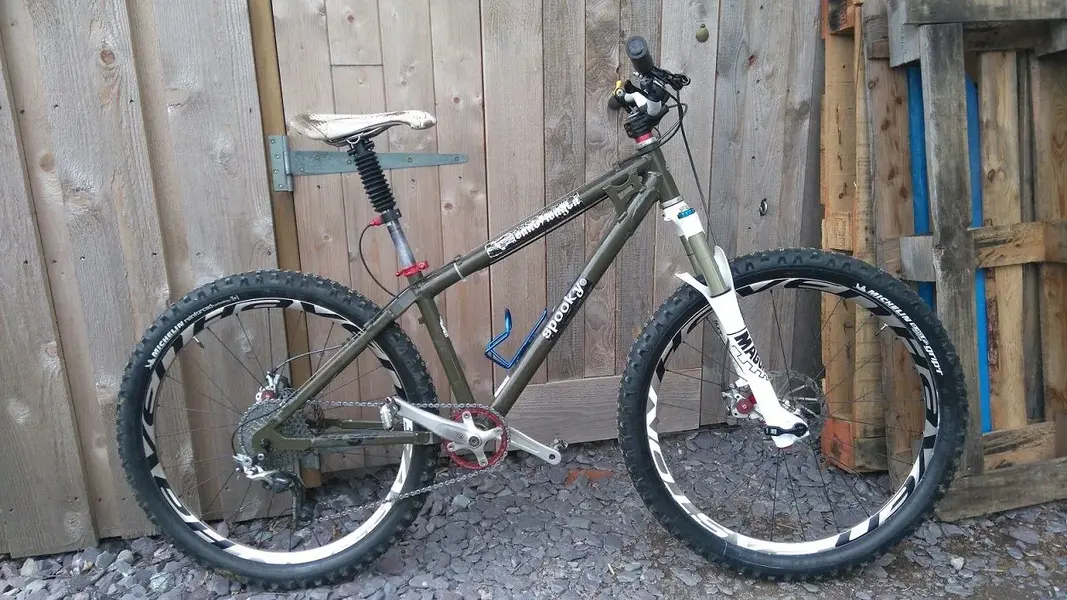

I love this frame. It's horribly dented, scraped and modified by me, but it'll keep on trucking forever and it makes me smile every time I ride it.

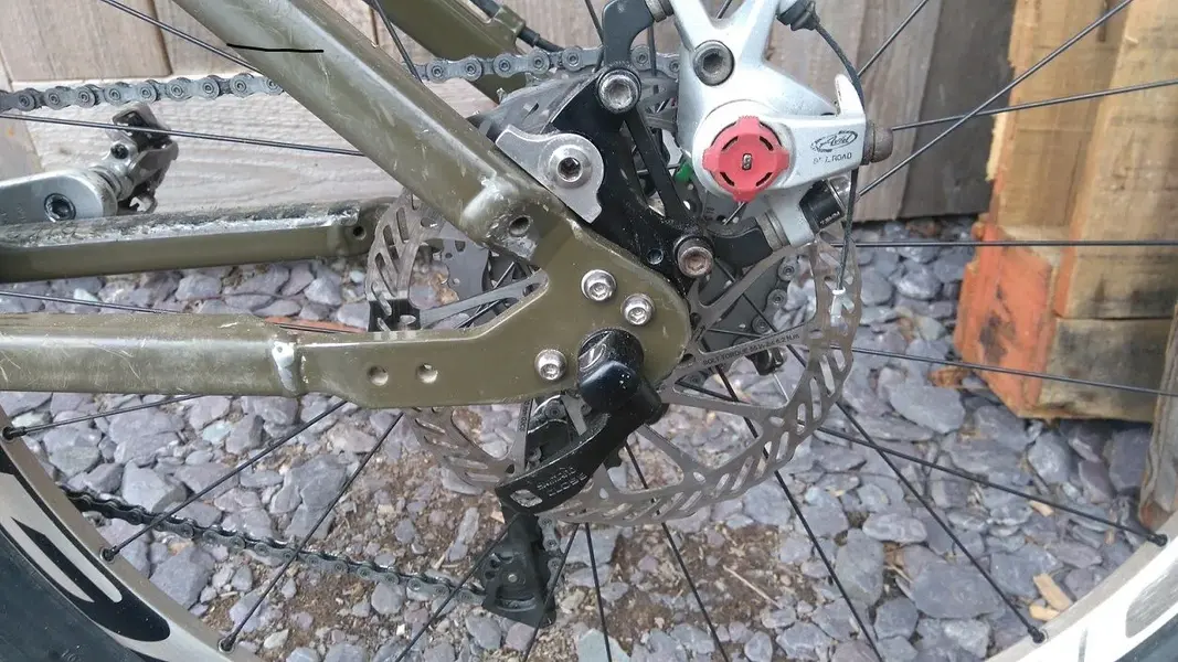

I use it for everything, so I decided to rivnut bottle mounts on, ream out the seat tube to 27.2mm to take a dropper post and drill the dropout to 'permanently' take a disc mount. Magura Thors are ideal as I can pootle round with them dropped to 100mm travel and set them to 140mm for the steep downs.
Picked up a pair of nearly new Haven wheels on ebay which have transformed it yet again.
Voila...
