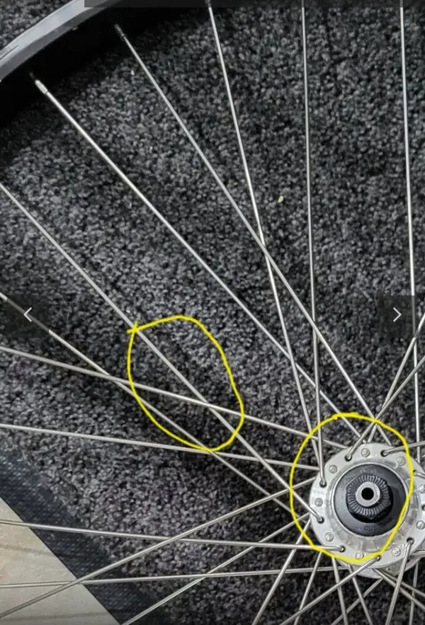

I've checked the new and old spokes side by side and they're both 270mm.Pattern makes a huge difference to spoke length a 4 cross would travel further than a 3 than a 2.
But If you say they are all 3 cross then there's only 2 things ot could be. You've bought the wrong spoke length or you've laced it wrong.
You've gptnabout 2 threads left on the nipple. Do no grind the spokes back.

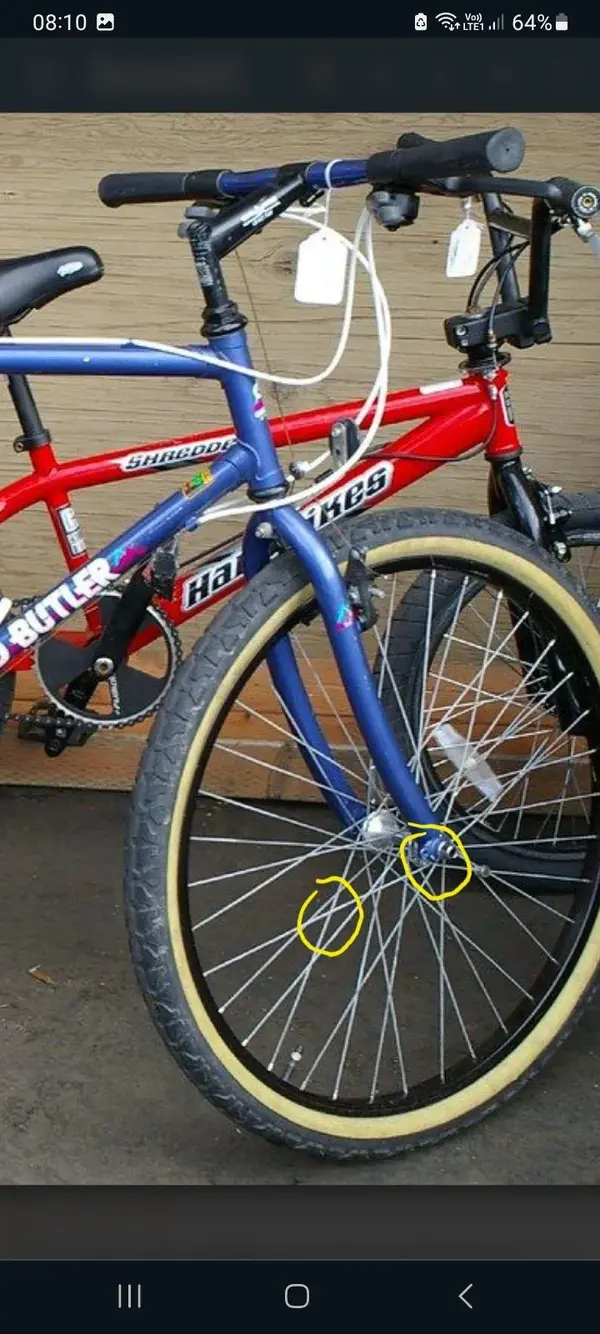

And I've checked the wheel spokes patterns, they match with my other wheels of my other bike 3 cross, and also match with a 3 cross wheel pattern when looking online,so no mistakes were made during assembly..
I'm thinking maybe i counted wrong before i disassembled the wheels and was 4 cross instead of 3??
