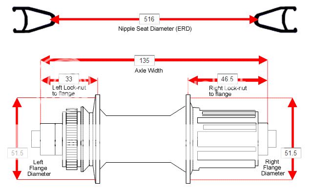

It may help to know they are 28 hole and I'm planning on 3-cross lacing. . . .??
Tell me this and I'll see what I can do.
Just order the spokes you need from CRC, as said they will split the sizes.
Hub make/model
Rim make/model
and yes 28 hoe 3x really does help.
Cannot number crunch if we do not know what we are crunching.

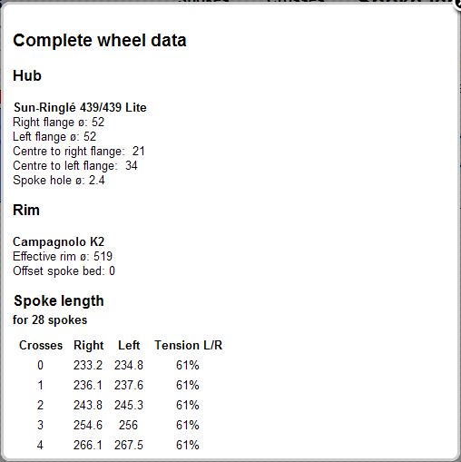

I use http://lenni.info/edd/ nice chap and based on spocalc that has been used fro ages.
If you use the Wheelpro site mentioned above and use DT 14mm nipples iirc, take 1mm off the answer, 16mm 2mm off.
If you wish to compare nipple lengths then take a DT12mm and screw a spoke all the way in.
Do the same for your nipples and compare the length. That it the amount you'll need to add/take off.
Wheelpro is designed so you can +_1mm to the answer and still be fine.
BUT
Front
would be 255.4 and 255 preferable but 256 would be fine.
Rear
254.6 and 253.2 so 252 (preferable 253) and 254 would be ordered.
(using Edd)

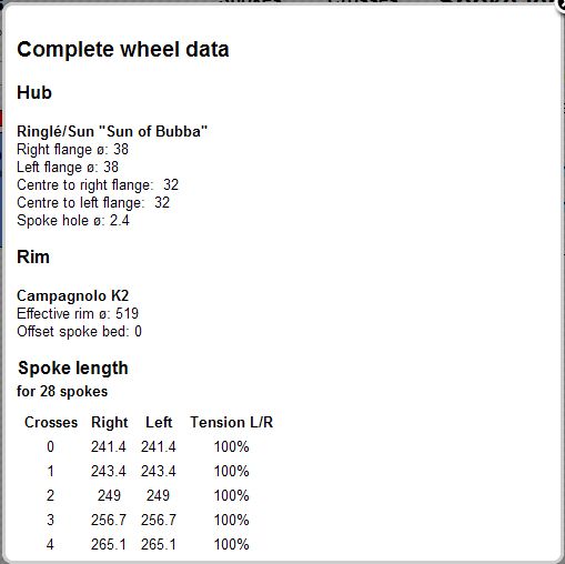

It is and hence the spoke lengths I gave. Not mmost spoke calcs work from the centre to the flange, not flange to the axle edge ;)
Just got the PM and will look at tit tommorow
Assuming what you pm'd me then are the correct hubs and rim
In common sizes (usually even numbers if from CRC)
254 and 256 for rear
256 for the front
CRC use 14mm nipples for some reason so possibly you would take 1mm off but looking at the numbers it should be fine. Send Cannondale King a PM if you want to make sure.
Worst that happens is you need to by some more spokes (or shorter/longer nipples) and you gain a collection of them. But at some point you just have to take the plunge and buy them.
