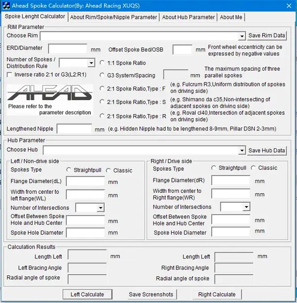

Ahead Spoke Calclutor,Intended for use with straight pull spokes
download:https://share.weiyun.com/5jCdnNx
