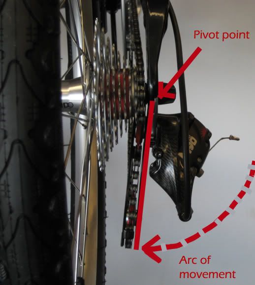

That's true until the derailleur is bent, because the cage is the weakest part of the derailleur an impact from the side will tend to bend either the cage or the derailleur hanger, in either case the lower end of the derailleur defines an arc with its pivot at either the derailleur hanger or the lower knuckle of the derailleur. A smaller bend at the hanger translates to a much larger movement inboard as illustrated in the hastily prepared image below, it's quite possible to put the derailleur cage in the spokes after an impact whilst the chain and upper jockey are still below the largest sprocket, rendering the disk useless.
I don't think cages get bent by impacts, do they? They just spring out of the way. You're right, of course, that a big impact can bend the hanger enough that the lower end of the cage is nearer the spokes, but those big hits tend to get noticed and corrected before you ride off. It's the little ones that just cause an overshift at the top of the cassette that are more dangerous, because it's so tempting just to tweak the indexing or shift to friction and ride on.
Clearly, there are circumstances where a disk may be useless. That doesn't mean there aren't other circumstances where it may be useful.
