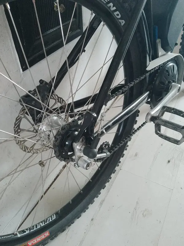

What's your setup with the BBSHD? Got any pictures of your bike?
I built the wheel ...can't remember exactly but a little bit of playing around with centreing the hub went on..pretty sure spoke lengths were within 1 to 1.5mm of each other.BB shell had I think around 4-5 mm machined off on drive side and a tiny bit of clearancing off the back of the main gear housing. Ended up with a chainline around 50-51 mm and equalised tread with old style road cranks that are about as flat as you can get. LHD crank needed 1 mm at the most on the inside off to clear motor.
So in all lots of headscratching trying to find 1/2 mm here and there but so worth it as it doesn't feel like trying to peddle a hog side saddle!
I wouldn't mind trying a smaller chainring for the extra acceleration but then that'd put me back to square one of poor chainline and cranks unequal tread! 😆 I've toyed with idea of making my own chainring carrier and finding either a proper 1/8 steel ring or go up a size to 420 chain. Maybe one day!

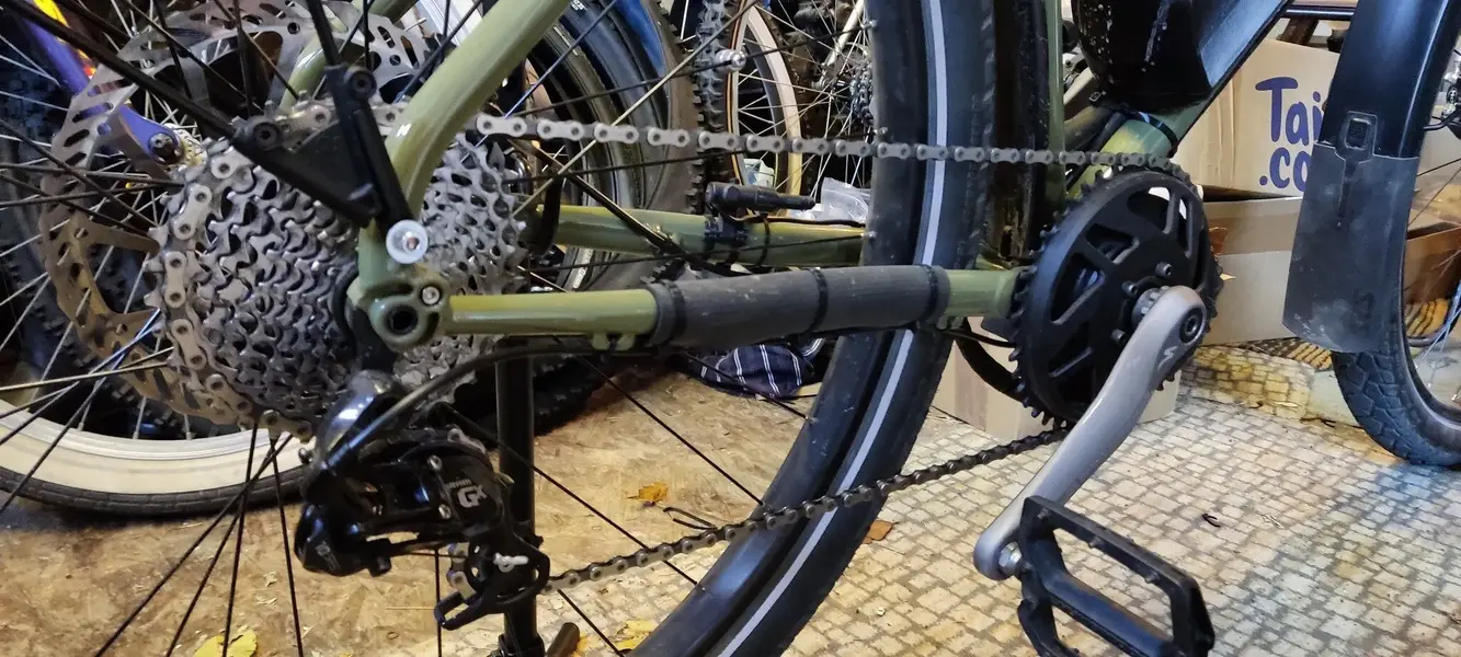

What's your current setup?
The bike's an on one bootzipper rigid 29er. SRAM GX 10 speed 11-36. I'm using a 42 tooth fake Chinese lekkie bling ring, although I do have a genuine 46 tooth too, quality seems the same. A 2 mm spacer behind the motor on the drive side so the chainring clears the chain stay, just, this bike was intended for tiny modern chainrings. Chain line is almost spot on, crank spacing isn't. Those are specialized strongarms, they've made it worse than the standard type, very wide and offset.
I could try the lekkie buzz bars, but I would like the 40tooth setup too, but all in that's about £350. So not now. I'll jus keep trying different cranks.
It's tricky fiddle isn't it each frame will have slightly different clearances around chainstays How much is oneside off?
I presume it's drive side...what's your current total tread width?
I haven't bothered measuring, it's sooo wide, drive side is about an inch further out than the other.
I don't mind the width and I could improve it a tiny bit by removing the spacer from the drive side bottom bracket and adding a spacer behind the chain ring, to keep the clearance. But really a straight crank arm on the drive side would be the answer. All fun and games really.
