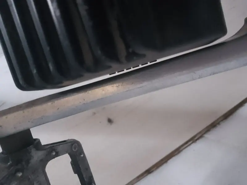

These are cranks from a 122.5 BB...a tiny shave was taken just to keep the gap equal over the motor...gaps about 2.5mm.....you won't apply enough grunt to flex them to touch the motor.
Standard bafang crank that gap would be around
8-10 mm...and boy those cranks are soft mushy junk!
