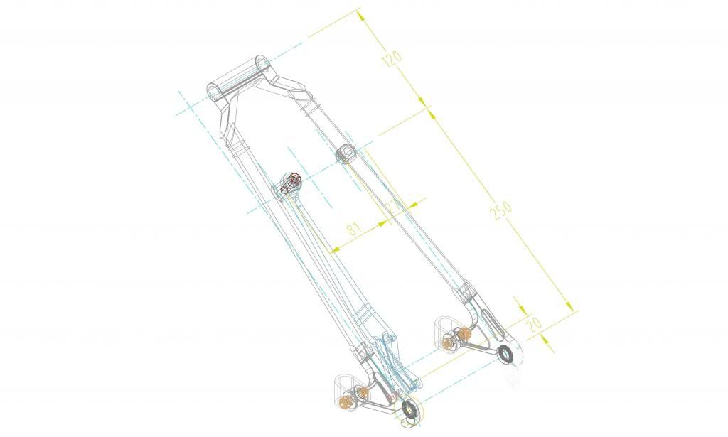

here is what i'vs got done

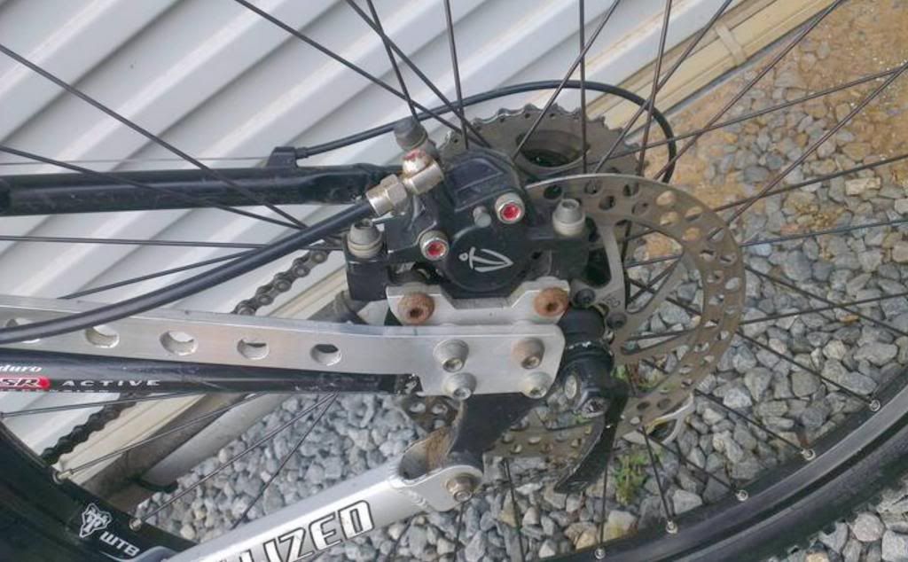

measured from my 98 FSR
figured out how to get the pics posted LOL
would like to know the distance to the drilled hole from the dropout centre line, currently i'm working on 20mm but i think it could be more,
so as to fit the predrilled specializd stays that came out on latter FSR's
any corrections welcome.
once i get the exact dimensions will weld up some steel prototypes will fit to an old rockhopper frame to test
when all is well i'll get some detail drawings done
i'm still looking at casting as i hav'nt got a TIG welder
