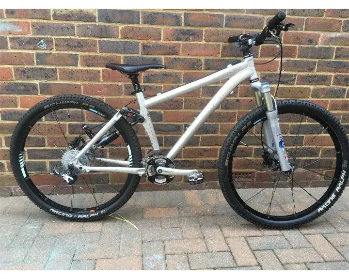

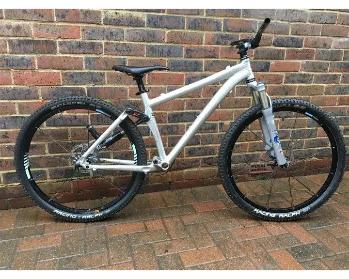

A little bit of progress today - his wrist is still very sore. :(
- Tyres and tubes on
- Discs on
- Saddle and post in

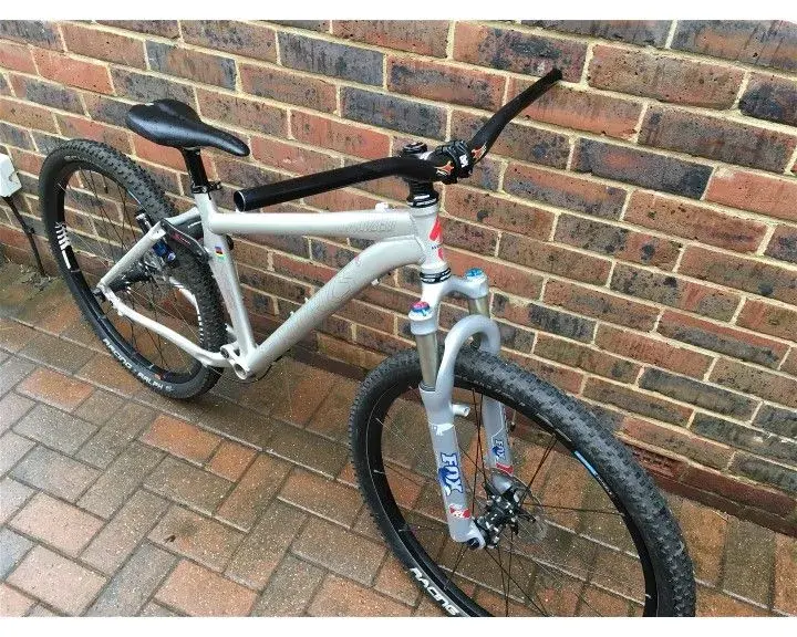

- Trial fit of the bars
Aside from the pumping up of the tyres which I did due to the wrist hurting, he did it all himself. I did check the tightness on the QR and the disc lock nut though :wink:
Cool or what?! We're keeping the NOS S-Works carbon bars ones in storage until we've got the width sorted. These alloy ones are the same rise / sweep and may be subject to trimming. As he gets bigger, we'll swap to wider carbon.
SP

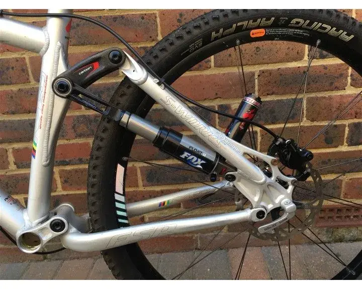

that rear shock set up is a bit funky and saves having it squashed in the front triangle
can we see a better pic of it ?
We had and experimental session trial fitting the brakes. I've ordered inserts and olives to shorten the hoses.
The bolts will need replacing or cleaning at the very least!

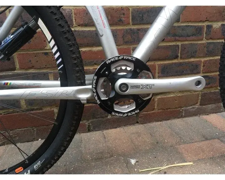

I have kept an eBay search running for XTR parts since Christmas and finally managed to buy an XTR rear mech for reasonable money (£23). This didn't save much weight, only 40g over the XT M750 derailleur, but looks cool :D
The arrival of the mech gave us a little momentum. On went the following:
XT M750 cranks - 545g
22t & 32t Shimano rings - 59g
Race Face bash guard - 106g
Steel bolts - 25g
Total 735g
this is spinning on the lovely Week Eight 156g bottom bracket. Crank bolts are ordinary Shimano steel jobs until the self-extracting ti ones I have bought turn up.

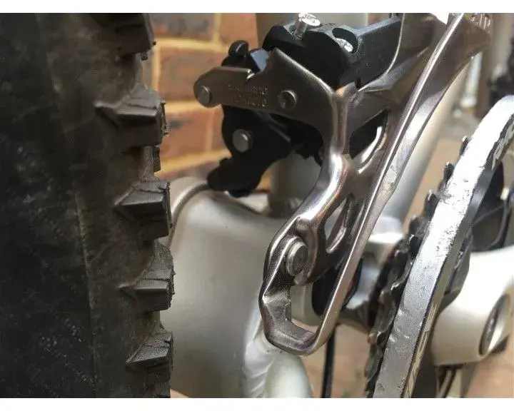

Now, here's the issue, front mech clearance! It had a low band front mech fitted from new but clearance is very, very tight.
