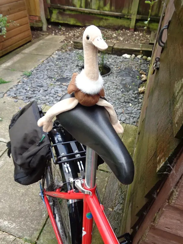

Specialized Rockhopper 1997 for Touring duties.

They have an 8 speed cassette rather than the original 7 speed that the bike had so will be fitting thumbies.
Strangely the original 7 speed shifter works all 8 gears on the new cassette.
Hi Ed, looking good! The shifter is an 8 speed one - it's always been an 8 speed setup - not sure where the confusion comes from? :)
Ha ha, that explains it. I read on the Specialized catalogue that it was a 3x7. I put the 8 speed cassette/wheel on and tested it and managed all 8 gears :):), I assumed it was a 7 speed shifter.
All's well that ends well !!!
Slapped on a Charge Spoon saddle to replace the old one.
Loaded it up with around 10kgs of gear, went for a couple of miles around the block, apart from the obvious weight issue when climbing and the front being light when lifting it feels remarkably stable.
All set for tomorrow :)
Hmm well I'm doubting myself now re the shifter but the wheel that came with it had an 8 speed cassette for sure. Being fussy, I didn't quite manage to get it to shift perfectly in my ownership which is now making me wonder whether it is a 7 speed shifter with an "extra click". Thinking about it I think STX is supposed to be 7 speed, it's STX-RC that's 8 speed...
I dunno.
As you say though if it's working well now then all good!
Have fun on your travels, hope the Rockhopper serves you well. :)
