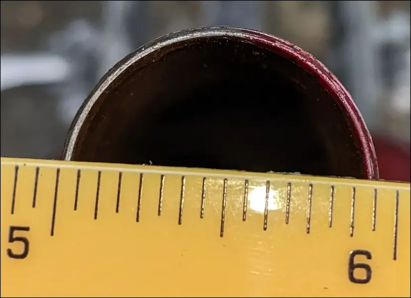

My understanding was the steerer was either going to be 1" or 1 1/8" and I'd get the replacement bearings based on that. Now I just measured it -
I'm assuming I need the 1 ".

As well as the cage being 1", you want the same size balls as the originals. They're probably 5/32" but, if you want to be sure, measure the size of the old bearings (in inches) using verniers then order accordingly from somewhere. If that's not an option, get the sixteen-bearing cage from Hopkinson Cycles.
