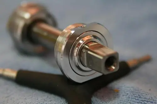

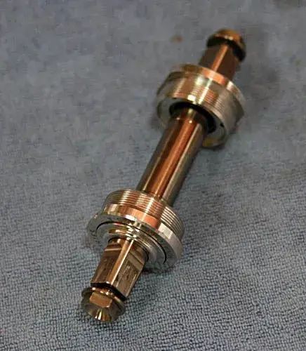

I have a Phantom 1991 BB. The cups just spin on and tighten with a 36mm wrench. The spindle floats so you can tap it to center it. Then tighten the 2mm set screws in the cups (flat area). On the bottom photo, see the hole on top of the flat part of the cup? There's a set screw inside. The cup with the lettering goes on the left. Other than that, it's a very simple BB.
I agree that is spins forever and smooth. I've never found a smoother bottom bracket.
I just took mine off today.
