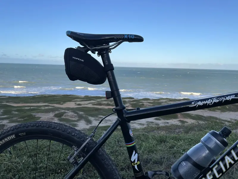

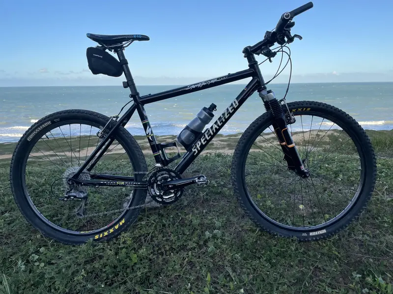

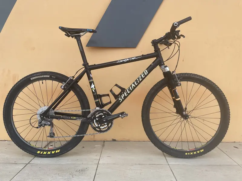

Specialized 1997 Stumpjumper M2 Comp

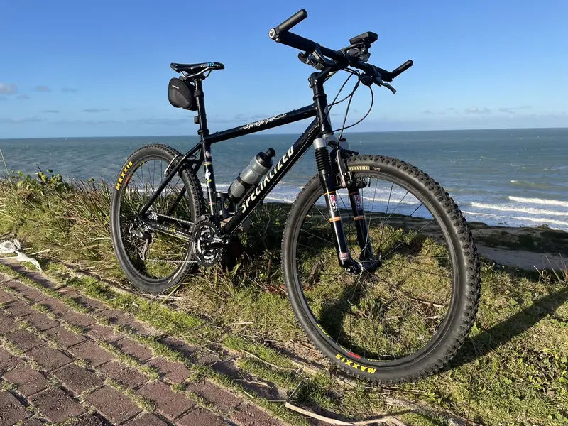

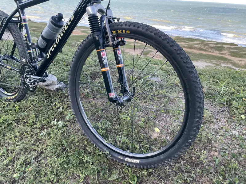

This is an upgraded build with original and unrestored parts of a Black Eye.
It doesn’t quite match the catalog specifications but keeps the magic look of the 97’ Stumpjumper. All black and dark gray.
Portrait
1997 Stumpjumper M2 Comp frame, size 18”
1998 RockShox Judy XC, 80mm
Chris King headset black NoSotto
Specialized black stem and handlebar
Bontrager Race Bar Ends
Ergon grips
Thomson Masterpiece seatpost
Prologó Evo Nagó X10 Pro saddle
Shimano XTR M952 group

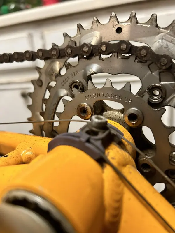

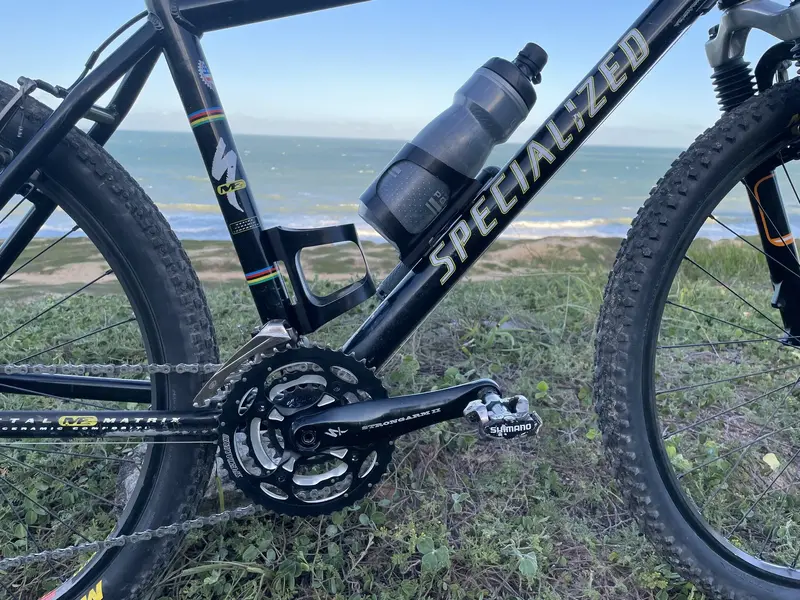

Specialized Strongarm II crank
Specialized 22/32/44T chainrings
Mavic 217 Sup Ceramic 32 holes rims
DT-Swiss Competition black spokes
Maxxis Crossmark and Ignitor 26 x 2.1 tires
Ringlé water bottle cages
24.25 pounds (11 Kg) at the end
First ride by August 2024
This build is somehow special to me as I used to race a 1993 Stumpjumper M2 Comp, the same frame.
Hope you enjoy,
Al (Alexandre)
