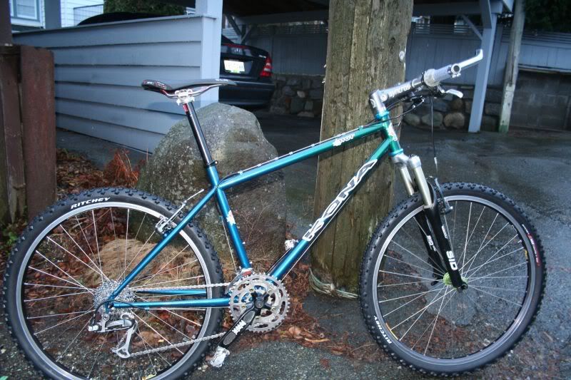

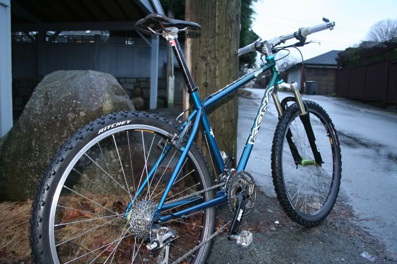

Finally have got this built up. Mostly period specific but some modern (brake levers and saddle). The paint is an wet application of emerald green to dark teal fade. Decals courtesy of Gil_M. Hope you guys like it!
Frame: 17" Kona Hot
Fork: Rock Shox Hydra Air SID
Headset: Chris King No Logo 1 1/8
Stem: NOS Syncros Cattlehead 1 1/8
Handlebar: NOS Syncros Hardcore
Barends: Kona Aluminum
Brakes: M900 XTR
Brake Pads: XTR
Brake Cables: Shimano XT
Cantilever cable hangers:
Brake Levers: M970 XTR 2 finger
Shifters: GripShift XRay 800
Front Derailleur: XT
Rear Derailleur:M900 XTR 8 speed
Cassette: XTR 12-32
Chain: Hyperglide
Cranks: Race Face Next LP ISIS
Bottom Bracket: Race Face ISIS
Pedals: M737 XT
Hub Skewers: Salsa Ti
Rims: Bontrager Valiant
Hubs: Chris King
Spokes: DT
Tyres: Ritchey Z Max
Saddle: Selle Italia Turbo Gel
Seatpost: NOS Syncros Ti
Weight: ?? (<26 pounds I think, (and certainly hope))

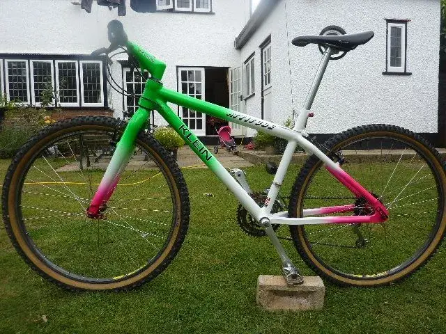

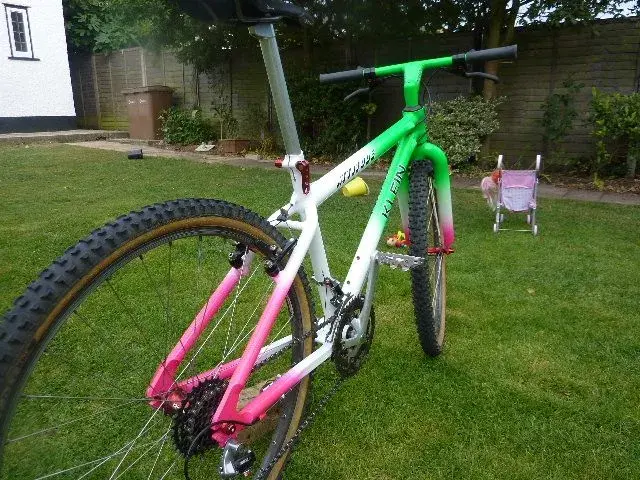

My not quite attempt at klein attitude 1990 superlight.
Back story of the frame is that it was ordered as frame only
from revolution cycles in Romford Essex back when it also had a section
that sold windsurfers aswell." shop is long gone"
Frame team USA frame XS
Fork Klein
Stem Mission control "which I cut down years ago" :cry:
Grips tioga bio grips
Brakes suntour xc pro non energising
pads suntour
cables suntour
hangers suntour
levers suntour xc pro
suntour xc pro 7 speed cassette
front der suntour xc pro
rear der suntour xc pro
chain suntour

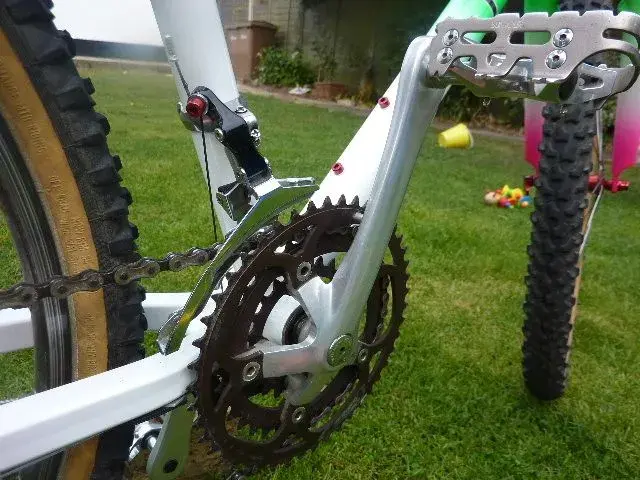

crank bolts titanium
crankset suntour xc pro
chain rings suntour
B/B klein ti 125mm
Pedals suntour xc pro
Saddle 1991 flite
seatpost american classic 353mm
seatpost bolt original steel ringle
Hubs ringle 32 hole
QRs original steel ringle
rims mavic 231 cd
spokes DT swiss stainless
tyres panaracer smokelite 1.9
ritchely megabite 2.1
weight 22.2 lbs
Not quite superlight territory of 21.5lbs but everything is period correct.
Nothing on there later than 91 I think.
I have posted bike up before but I've changed a few things and
here it is finished .
Any sugestions on how to shed a few gms while keeping it period correct
would be well received. :lol:
