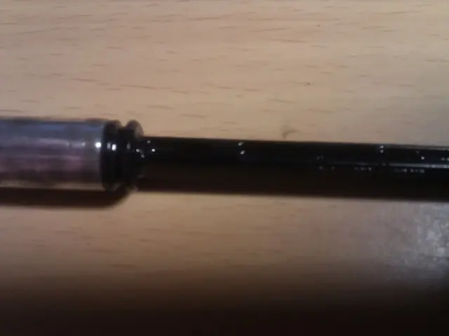

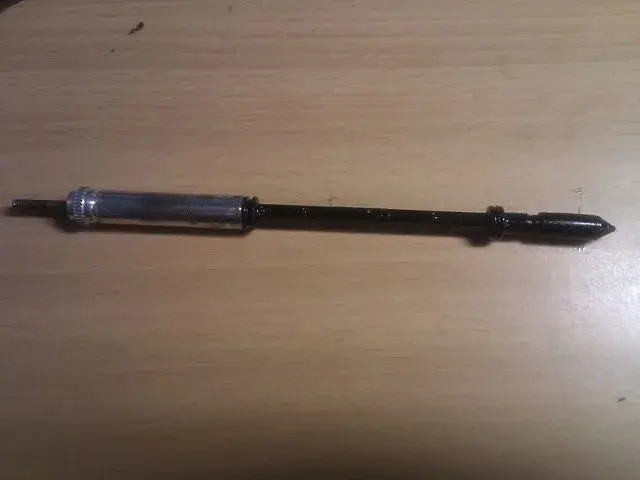

Also just noticed am missing a small o ring on this what ya ma callit
hi it hasn't slipped off and run up the rod.....in the pic i can see 2 ? close together.just check that you have 1 for each groove

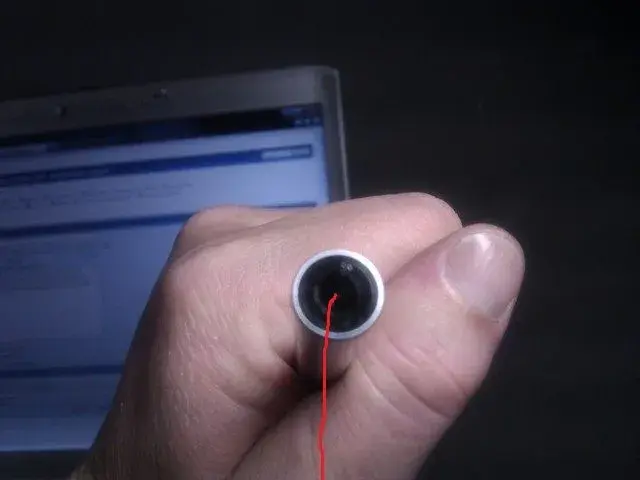

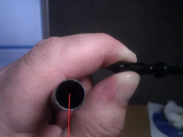

now for the cartridge first pic is of the top it has like a black stopper in does the oil go in there doesnt look like theres a hole there
or does it go into the hole in the next pic
i must admit i'm getting a bit fuzzy headed now as new baby in the house and lack of sleep is making it hard for me to visualize fork close up..if you get stuck putting it back together, i'll try and help out with each specific issue if and as they arise.......
....wasn't sure where that shorter pointy tipped rod came from ?
