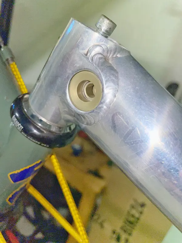

I picked up a ‘94 Stumpjumper recently that came with mostly everything original, and it hadn’t been touched for at least a decade. I started to restore it and I’m having trouble getting this stem off the headtube. I removed the still-intact syncros plastic top cap and kept it aside for obvious reasons. And even removed the screw from the side fasteners, but the thing won’t budge. Tried lubricating, force and using those special words but to no avail.
Can someone explain how to proceed?

Thank you. I will try this. I’m assuming each wedge comes out in the direction it faces?
As in, it’s not just jammed into one horizontal entry hole bored to the same diameter, that allows them to slide in from either direction?
I’ve removed the wedges as instructed. It hasnt made removing the stem from the steerer tube any easier.
Still won’t budge.
Hold the fork legs and use a rubber mallet to tap the stem sideways to break the joint. Once it moves you can wiggle it from side to side whilst pulling upwards
