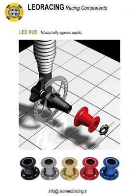

There are Lefty hubs, not made by Cannondale, that have an inner hub with bearings which the disc mounts to and then the wheel has a hub shell that fits over this inner hub. No need to remove caliper as disc stays with inner hub and I think they even have a quick release too instead of the bolt that is on Cannondale Lefty hubs.
That'll be Leonardi:

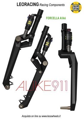

Who also make this:
if you're into weird forks :shock:

can you use this on any lefty wheel / hub or does it only work on with the use hub? Are there any adapter or something... (sorry if stupid question) :oops:
