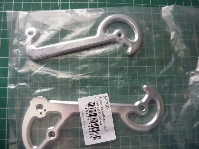

The trend to fit very large rear cogs to tackle the long hills on the Eroica events can cause problems with chainwrap and gear selection issues.
These long cages allow a longer chain to be fitted so that low gears can be used with normal length rear derailleurs. I brought these long cages for the recent Eroica California to use on a 31 tooth rear and 39 front setup, but didn't need them when a local bike mechanic at the event showed me a better solution.
These cost £40 from the USA with £25 import duty. They are yours for £50 posted.

In my case the better solution was to removed the stop screws in the drop outs and locate the wheel as far backwards as possible, and my bike has quite long derailleur arms, so a combination of these features and careful cog changing meant that I could ride comfortably up 16% slopes in the event.
The long cages were originally designed for Campy gear, but I believed can be fitted to any type of derailleur.

So here's a dumb question :-)
If I swap out a short cage Xenon for a long cage Centaur mech, what are the implications (other than it'll look way nicer, which is part of my weakness, and it'll match the rest of the Centaur gruppo, which is the other. Notwithstanding my ignorance)?
All / any answers welcome...
Re: Long rear cage - Solution for large cogs on Eroica bikes
Essentially no problem. You might find it runs nicer with a couple of extra links in the chain, depending on how tight it is on big-big.
