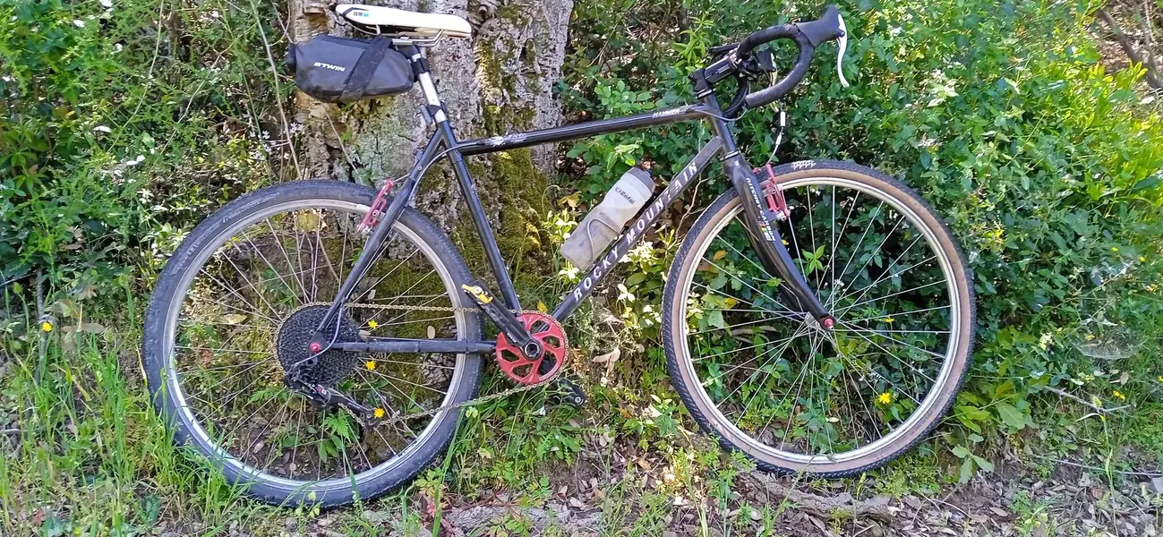

1991 Rocky Mountain Hammer. 28 inch ft wheel, 27.5 rear, The brakes have longer rails to adapt 26 ich frame and forks to larger wheels, Ritchey carbon forks, vbrake compatible road levers, a mix and match of other parts. 22 pounds, not too bad. Pretty comfortable ride, even if not too sprintish, if the word even exists. Not bad. Ah, Redshift stem.
