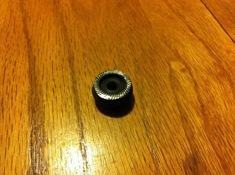

Will buying a new axel solve this problem? The hash marks on the axel nut that mate to the frame appear filed down.

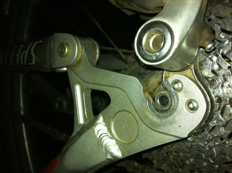

By what you can see in the picture; does it look like the frame it's self is worn and causing the axel slipage?

The axle is fractionally too long as it is so the dropouts aren't nipping up tight enough to hold it securely; you need another thin washer or two in there so that there is fractionally less axle in the drop out then you'll be okay 8)
Looks to me like the QR nut is worn, causing it to slide under pressure. The "wear" on the frame itself is merely the result of the QR nut sliding around.
Getting a new Shimano QR should solve it.

I think we are stevo may be right. I would check whether the axle is precisely centred on the hub. If there is more axle protruding from the hub on the drive side than on the other side, that would be expected to cause this problem. The end of the axle has to be inboard from the surface of the dropout even under compression, otherwise the skewer can't do its job.
You may be able to solve the problem with some washers, but if the axle isn't centred, the fundamental solution is to centre it.
Although it's true, as others have said, that the nut and the dropout are worn, this may just be part of the symptoms rather than the root cause.
Looks like a lot of wear in there to me, but that might just be wear caused by the slippage which is getting worse all the time.
Now the axle, yes, I would be inclined to agree it is a tadge too long in that drop out, but something to check perhaps, how much axle is available for riding in the drop outs on either side before the QR is tightened. I say this because recently I discovered on my back wheel there was more on one side than the other, meaning that with the QR tightened, one side of the axle was nice and tight and the other not so much. How I found it, was I was having bearing problems on the cassette side, so a bit of trial and error and the axle is now correct, bearings happy, everything in line and centred and no problems.

...you can see in the photo' that the end of the axle is all shiny where it has been fouling the quick release; turn the bike upside down, nip up the quick release and note the position of the ends of the axle in the dropouts.
If, as suggested above, the axle isn't centred (more axle in one dropout than the other) adjust as necessary. If it is centred add a washer either side (behind the final nut) and it will stay tight 8)
Is no one else noticing that there is no sign of damage to the inner surface of the QR nut? Surely if the axel was fouling and therefore preventing the QR from tightening, then there would be damage to the inner, recessed surface of the nut... Also, due to the depth of the QR nut, the ax would have to stick out a hall of a long way!
My money's on just the damaged QR
