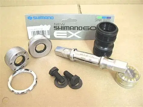

Wondering if anyone can put me in the right direction to find a slim bodied bottom bracket. I need a 73x127mm but slim bodied as my frame has the cable routing plate that passes through into the frame where the bottom bracket fits.
Any help would be greatly appreciated. Thanks.
You won't find anything slimmer than this type. You don't need the plastic body in the middle.
Had a similar problem on a AL frame once - with some jiggling, something from the UN7x series worked, the body tapers down in the middle.
