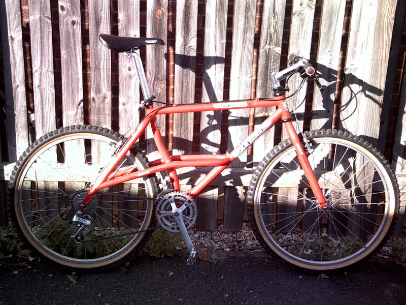

I'm 6' 2" btw. Some past rides below.

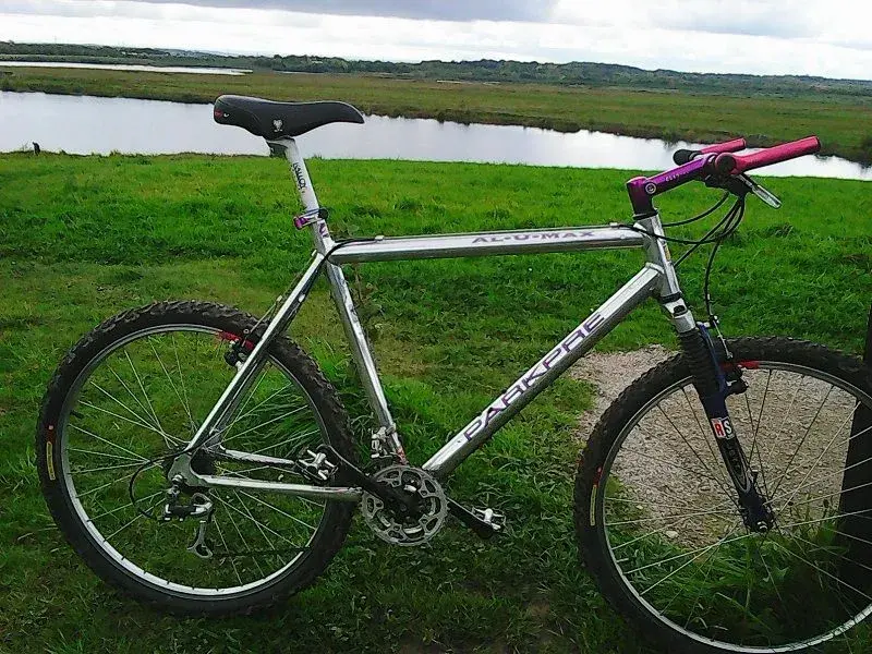

I apologise for the thread hijack, but that Parkpre looks very similar to a mystery frame I've had for a while.... (I thought it might be a Orange or Marin but there are subtle differences to both. Could you drop me a PM please?
Hiya mate. Ok I see some similar features on your frame, cable route for rear mech anyway. BB shell was 68mm, seatpost iirc 27.0mm. The alumax had a certain quality to the finish, almost clear anodised and silky, where marin go a bit rough.
1.1/8" headtube. And the mech hanger was the 3 bolt A-pro effort.
Didn't record the serial number. Sold on ebay a couple of years ago. You know to someone who cared not about bikes and got it for pit'ence. Seems to be my kinda black cloud.
