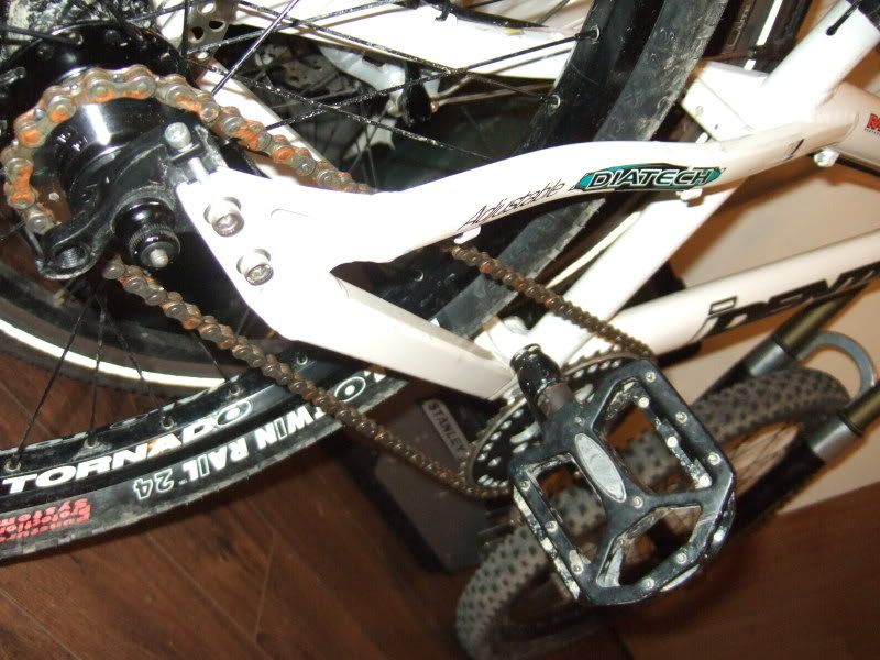

I've been learning a bunch of the info in this thread gradually and from all around over the last 6 months or summat.
I started out with My Identiti Dr Jekyll, I was retrialing the 24" wheels I've never been totally sure about and 12-25 gears were pointless really on those wheels.
DMR kit and sliding dropouts made this easy, now on 26" wheels again I might even like it when I get to the hills again feels good on road and mucking about, running summat like a 16 40 (or38?)
I 'upgraded' the gears on my 8x1 Revolution Courier Race to the 12-25 and Tiagra mech, then one day chain jumped off and slipped on leaves!
It as flat as a supermodel here so I used one gear only on my commute to get the right one, after some testing and calculating...
Bought an On-one doofer (its al right for the money i suppose, and Max at londonfixieshop sold me a spacer kit and 16t Shimano DX cog
I'm sure the old crap chain ring was ramped :roll: and quite worn, new Thorn item was ace compared
Bit more testing and a proper SRAM PC1 chain, and my wishes came true...
Bit tight but rides fine! :D so far so good, exactly right gear for my short commute 16 46 :)
