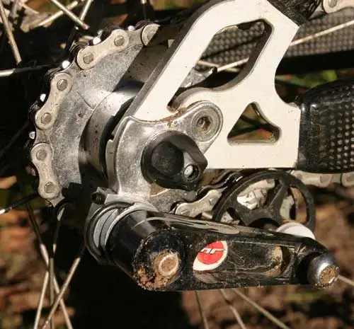

Even one extra tooth will make a difference -- 6 teeth up to 7 is quite a lot in percentage terms :)
I've always found push-up tensioners to be more effective, you can get the chain round more than half the sprocket:
that looks tidy ! is that a DMR one ? mind me asking where you got it and how much you paid for it ?
It's a DMR Tension Seeker. All the usual online shops sell them. They appear to be £40 now, though -- I think I'd use an old mech ;)
