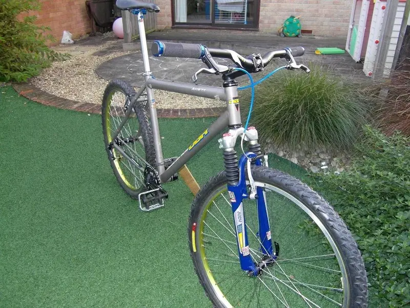

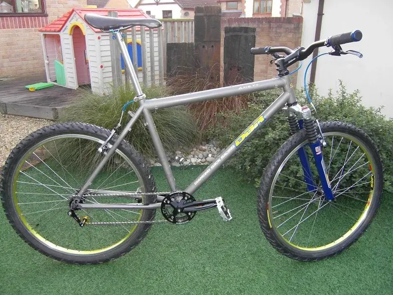

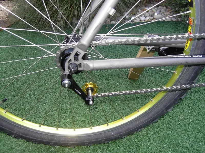

OK, I posted on this thread a week or so ago about converting my DBR Axis TT to a single speed, and now I've finished it. Well it looks complete but I have a glitch to solve I think. I only jumped on it quickly tonight to see what it felt like and though I could only fit in few pedal strokes around the garden I immediately felt a 'jumping chain'. Like when you put a new chain on an old sprocket. It's all new of course. I've posted a few pics to show what it looks like. Some new stuff on there, so its not all retro I'm afraid. I like the look of it, I just need to sort the jumping chain issue. The drive chain is.
Chainset: Raceface Ride XC SS - 32T
Sprocket and spacer: Gusset Double Six 16T
Chain: SRAM PC1 SS Chain
Tensioner: Superstar Sprung Tensioner - Gold anodised Jockey Wheel
Any clues what's up?

I have the same problem with my single speed build completed today. Did not have time to sort today but it the first job tomorrow and it only skips under load. I used an 8 speed chain KMC Z82. Rear sproket is a single speed 18T (I forget the brand) and chain ring is a biopace 38T. The chain rings are the orginals but don't look worn and the sproket is new as is the chain. The ratio is perfect and bike is super light.
I suspect yours like mine has a chain line problem. I thought mine was all lined up, aparantly I was wrong or it something else but there really is nothing else.
I hope you sort your skipping problem and enjoy riding it.
It's the tensioner. I had the same problem with mine. I swapped it for a DMR one that pushes the chain up rather than down and now it's perfect :D
AdrianStreet1973 - it jumps because the chain is too long. You need the chain to wrap around more teeth on that 16T rear sprocket.
Ok, so it's not the chain line. The tensioner alignment did look a smidge out when I checked it. It's dead straight now, but still it jumps.
I'm suspicious about the SRAM 'snap lock' joining link as when I turn it backwards it makes 'click' when it goes through the jockey wheel. However when I pedal it forwards with the wheel off the ground (no load) it sounds fine.
I wondered about the wrap around, but this tensioner doesn't have a huge amount of range left in it. I could take out a link or two perhaps, but after roughly taking up the available slack to the limit of the tensioner by hand I bearly get an extra tooth wrap around on the rear sprocket.
I might try taking out the joining link tomorrow to see if that improves the problem. Otherwise I might be looking for a new tensioner. But it seems odd because this one seemed well recommended, and it's not fundimentally different to so many others.
Oh and I liked the gold jockey wheel! :(
I have the same [ish] tensioner and it will go tighter than that.

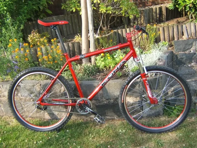

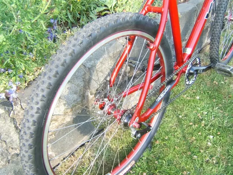

Ill have a look for one of my pics of my SS built
OOOO them knee's :(
