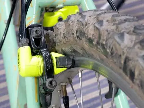

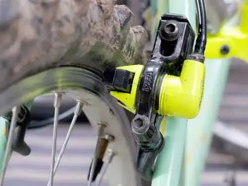

As promised Simon - a few photos of the Magura set-up on my Explosif.
If you compare my photos to yours, you'll notice that although yours works (and mine doesn't) its the little details that make or break it.
For a start the centre to centre dimension on my U brake studs is 90mm, equating to 99mm O/A (versus 94mm for yours). Also I think that my studs are positioned a few millimetres higher than yours.
Anyway, all this means that I can't get the pads any closer to the rim than 6mm - I am unable to angle the whole assembly in slightly to take up this clearance as that would put the brake pad into the sidewall of the tyre and the cylinders are hard up against the mounting adaptor.
There's not really anywhere that metal could safely be removed to give more adjustment, not even at the top of the mounting slot - besides, the whole adaptor is only die-cast from "monkey metal" so I don't think it would stand much modification.
So, unless I'm missing an obvious solution (like an 8mm wider rim...) it looks like I'm out of luck. :(
I look forward to your thoughts on it anyway.
Andy.
