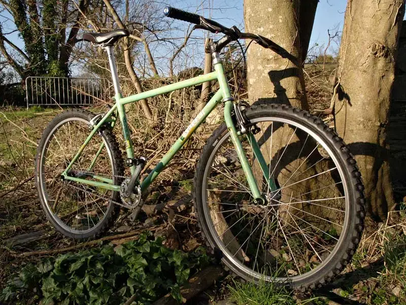

I've started running my '88 Explosif as a single speed - initially just as an experiment , but now that I've found that I like it a lot I plan on using it that way for a while at least.
At the moment I'm running 32:18 which, as luck would have it, I can do without having to use a tensioner. That ratio is a bit "spinny" on the road to say the least, but as I only need to travel at most one mile to my local trails I can live with that for the minute. Plus, I appreciate the slightly lower gearing on the climbs...
I am, as a temporary measure, using a single 18T sprocket from a HG cassette spaced to suit the freehub body but ideally I would like to use a deeper tooth sprocket and proper machined spacers.
However, as I am using a 7 speed freehub I guess that kits like the Gusset or On-One convertors won't do the job unless I machine 4.5mm off the total sprocket and spacer width? Is there anything out there that will fit a seven speed freehub with no mods?
Also, what's the best chain tensioner available - (obviously I'll need this if I want to use different sprocket combinations) and what chain would anyone recommend? - at the moment I'm using a SRAM PC890.
Cheers,
Andy.

Have a look at the dmr kit which is made up of multiple spacers, could be made to work on 7 speed. Theres a good pic on ebay.
Thanks Kaiser - yes, having had a look it appears that the DMR one would work ok. I might give it a try anyway.

I busted up old cassettes and a used an HG cog when I first built my Explosif up as a singlespeed. There are a heap of kits now that are built of individual rings. Nicest being I think the Endless Bikes Fibonacci - they deserve a plug.
http://www.endlessbikes.com/products/components/spacers.html
I use 33 x 18 which is also a bit spinny on the road but perfect for the hills and singletrack where I ride.

Im currently running a Lava Dome singlespeed,36:18,using a Surly sprocket as the tooth profile is deeper,i had the same problem with my 24/7 spacer,i filed that down to suit and eventually got it right,i use a gusset tensioner,not the best but not bad.

Well messiah - of course I'm stuck with the U-brake, but it looks pretty cool and a lot of these young whippersnappers have never seen one so it gives them something to laugh at :lol: . I have a home constructed travel adaptor fitted which lets me use the same levers for front and rear brakes though.
