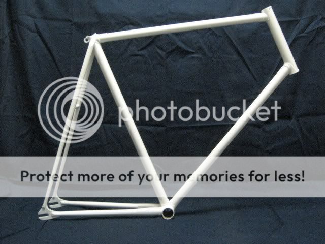

The frame is still at the powder coaters due to them having problems with grease in the BB shell contaminating the white powder coat during application. Apparently they have stripped and applied powder coat twice but weren't happy with the finish, so they've stripped it again.

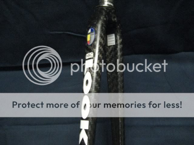

I've also sourced a 1" steerer extension from one of my suppliers so that I can make use of a set of straight blade carbon forks from a Giant TCR. The steerer was to short for the frame so I purchased an extender but had to have it turned down by an engineer in order to fit the internal diameter of the carbon steerer.

Right, I've just got my frame back from being powder coated and I'm very pleased with it. I'll upload some pictures very soon.

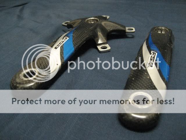

Further progress has been made with sourcing components. I've picked up the following;

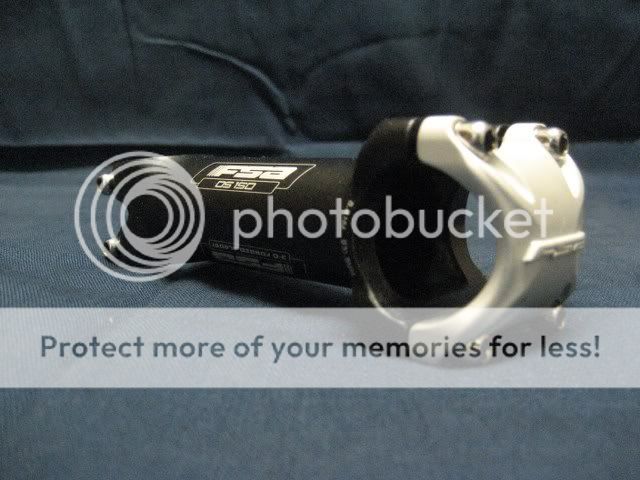

FSA OS-150 Stem - Black

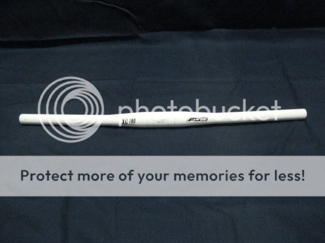

FSA 180 Flat Bars - White
FSA Seatpost - Black
FSA Carbon Chainset - Carbon with blue flash.

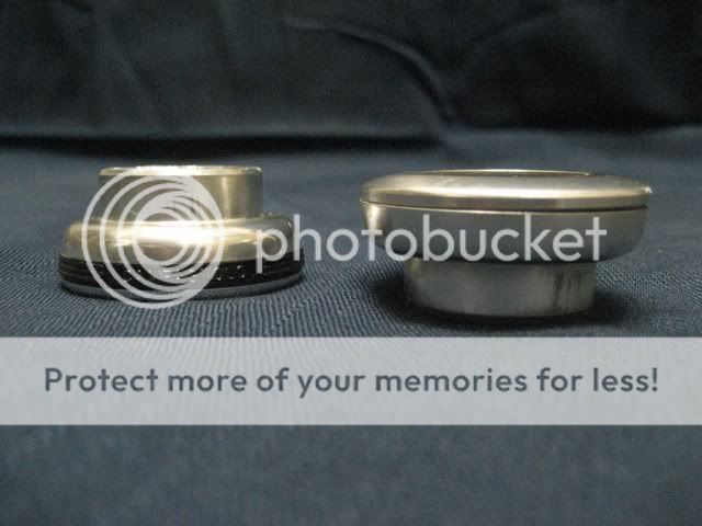

I should be dropping the carbon forks off tomorrow (Sat 13/11) to be sprayed up to match the frame and I've just fitted an immaculate 105 headset I had laying around.

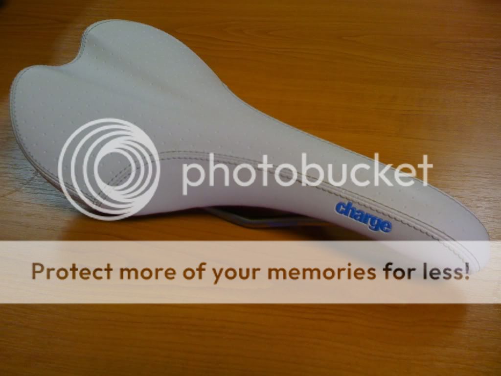

Final purchase is this Charge Spoon saddle with Titanium rails.
I'm really looking forward to seeing this one done - I like the mix of modern components with a retro frame, should look really smart
