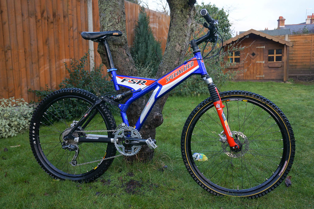

Finally! After upgrading the group set and having fun getting a new BETD linkage and shock - I got to take it out today and I love it! :D
Had a fair bit to learn when it came to the link & shock seeing as all I've ever done before was lube the chain and basic adjustments. The peeps on this forum were a massive help :thumbs up:
I regret not going for a single up front though. Instead, for some reason I decided to go for bigger rings :facepalm:
Next bits will be 120mm forks, headset, stem, etc. Need to get saving... again.

that is a mighty fine example sir!
i'm just about to rebuild mine with a more period-ish groupset and some magura rim brakes :) can't wait to get it all set up a bouncing around!
Thanks Twain!
I've just been looking through your '99 Elite FSR build thread... very nice! That's not the one you're rebuilding is it?
