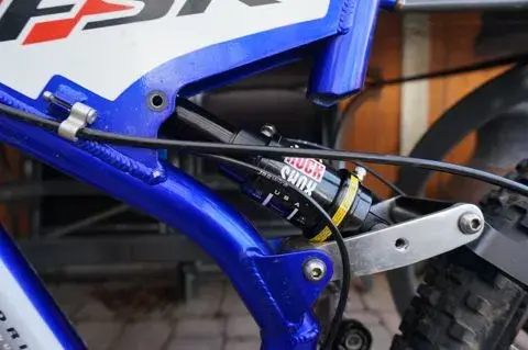

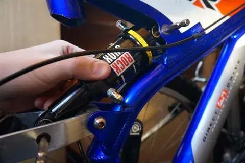

I ended up buying a used RS SID dual air shock but it didn't fit. Either the main body touched the linkage or the top valve would've touched the frame if fitted the other way round.

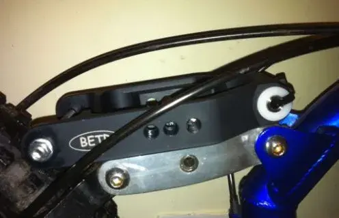

So, I've ended up just getting a new linkage from BETD.
I've yet to fit the shock (need to do bushings) - but the linkage is in and looks great!

Some pics to illustrate what I mean:
Thanks for the pics, great to see someone keeping another of these bikes alive, mine's the same colour too! The BETD link looks absolutely fantastic, shame they're so pricey :-(

My suggestion would be to post in the 'Wanted 98+' forum, stating that you need a 165mm e2e and NOT RS SID dual air..
I also have to run the shock 'upside down', but one further word of warning is that DT Swiss and X-Fusion use differently-sized bushings, .2 of a mm smaller if I recall, so probably best to avoid those unless you have helpful spacer/shims, as new bushing kits are about 20 quid each..
