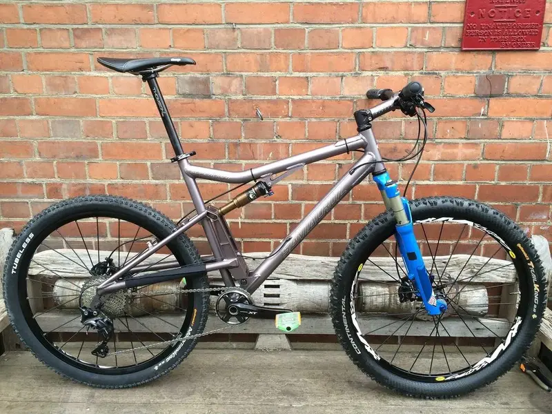

And my latest purchase...
swapped out the silver bars, stem and wheels for the black world force bits and the deore/sunn mammoth rims you see fitted here. Shifters needed a good flushing and some new gear cables, and the brakes needed setting to the new rims but other than that this one was ready to go, which makes a change from my usual full strip down and rebuild approach. And the blue looks great in the sunshine!

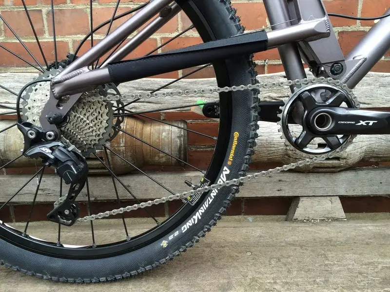

Putting one together myself 8) They are such a great ride..
..and Done 8)
Got to love that colour! :D :D :D (why do they always look a bit pink in the photos?)

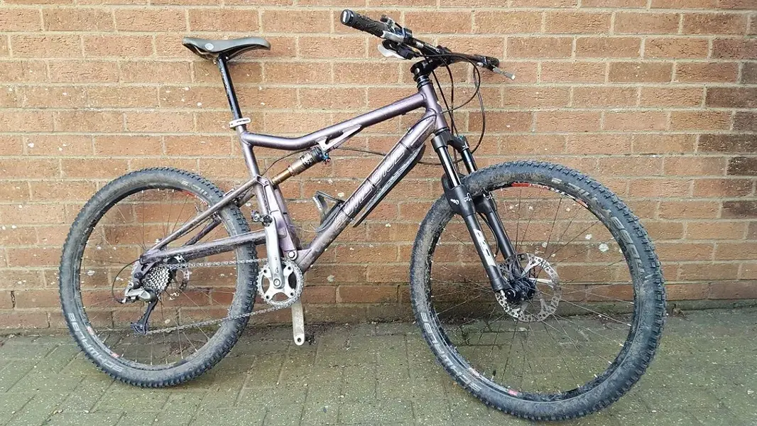

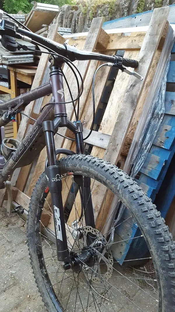

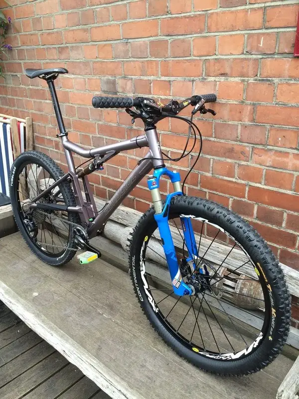

"New" additions to mine:
Pace RC38 LT forks
Change to 1x9 with 34 tooth Race Face ring
Stans Crest on Hope Pro 2 Evos - Nobby Nick tubeless
10mm/9mm thru axles - not 100% convinced I can feel the difference here :?
25 lbs on the bathroom scales!
(sorry its dirty)
Nice @ firedfromthecircus 8)
Always something cool about a Red main frame with a Black rear..
