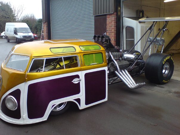

do you know the guy who built that? wayne somebody i believe?
looks like a heavy netal teddy bear
Wayne Allman of the Intergalactic custom shop.
Boy is he a good with a torch! 8)
