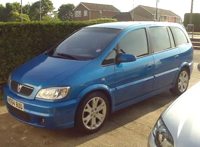

Took my new beasty in to Power Crazy Motorsport in Lincoln last week to give it the once over.
New cam belt, oil and filter, clean the Pipercross panel filter, new fuel filter, clean the injectors and new plugs.
Lovely and smooth now, and it seems to be a tad more economical. 28mpg round town, and it managed 39mpg on a run.
